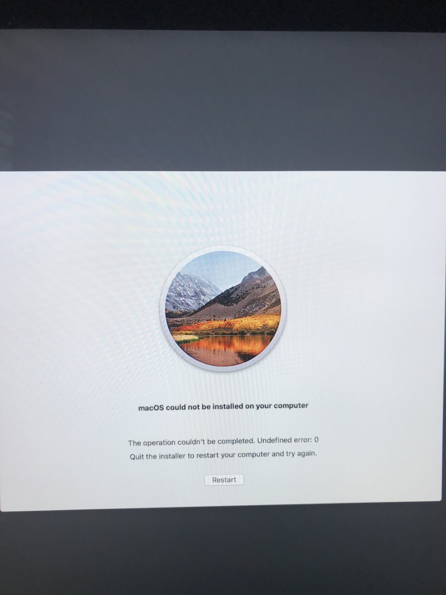

ok yesterday I update the High serrira secrity patch ,
now i keep hang what Mac installer , undefine error 0
what to do ?
sorry for my poor english , I try to click start up dish also same issues
while loading it keep mention undfine error 0
Ok guys sorry for my poor english pls bear with me hope u all can understand. i really going nuts....spend nearly half day try to get my iMac boot to desktop.
I even message one of the mod hope he understand can help
so what happen sorry to say again "
yesterday happen high serria got new update for security patch , so as usual I go update on this old iMac should be in the year of mid 2014.
all along is ok while doing update . I never update to new OSX as this is my old iMac only using High Serria
now the problem is keep showing
Mac OS could not be installed on your computer
the operation couldn't be completed. Undefined error:0
Quit the installer to restart your computer and try again .
Actually so I do as per normal ,
I even try these two option while I quit the installer.
it will pop out say
Are you sure you want to quit Security Update 2020-002 installer?
so there here cancel , Restart , Start up Disk.
I tried both Restart and Start up Disk option
SAME error message come out while i restart the iMac.
Ok I google around check , so there is recovery mode, press command R
so I did that . since start up disk from my HD can't work
I go reinstall OSX ,
Once inside I can see two partition of my HD
One is Mac HD another is Recovery HD
I also try both two HD but is Locked thus can't install.
now I really in lost....need urgent to use this iMac by monday for work
still got one more day to get it done fix
Any kind souls bro knows what I mean here? sorry for my poor english
Need help by Monday thanks

Ok , I already piss off....think going to spend entire night can't sleep.... Currently i manage to install High Sierra as I earse my Macintosh HD .
but just now can't install claim what disk boot disk I quite anxious and close it too fast never see closely
Now I try again installing currently left 15 mins like that cross finger can able to boot.
