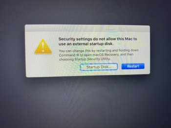

I have screwed my MacBook Pro 2019 I made a usb install of Catalina and was gonna do what I used to do and deleted the partition on the disk and now can’t install it, it says I need to change startup security utility but its won’t let me, I know it’s something to do with t2 chip but now I’ve wiped the machine what can I do?

Boot into internet recovery and install the OS. Always best to do internet recovery as it download the best drivers for you current Mac.

Internet recovery installs the version of macOS that was shipped with the Mac. I don't see why there would be any difference worth worrying about between a totally clean Catalina install and a clean Mojave install updated to Catalina. Just let the Mojave install finish up and then update.

If you want to change security settings it can be done in normal recovery mode . There’s a tab at the top option that allows you to change security boot settings
Booting into command + R and under the utilities tab. You can change the startup security
Can I install Mojave how it’s doing it then change the startup security and do the same and install Catalina from usb if I allow it

Boot to internet recovery using
Option-⌘-R
instead of
Command (⌘)-R
This will make the Mac look for the latest version of Mac OS supported on your Mac instead of Mojave.

Thanks guys I think it’s working I installed Mojave then changed startup security to allow and now booted from usb and deleted Mojave partition and it’s installing Catalina :) just feels nicer having fresh os installed

Because of what you did wiping the disk the T2 chip won’t allow the boot from your usb device, this is effectively to stop people who steal laptops from wiping and setting up as new.
