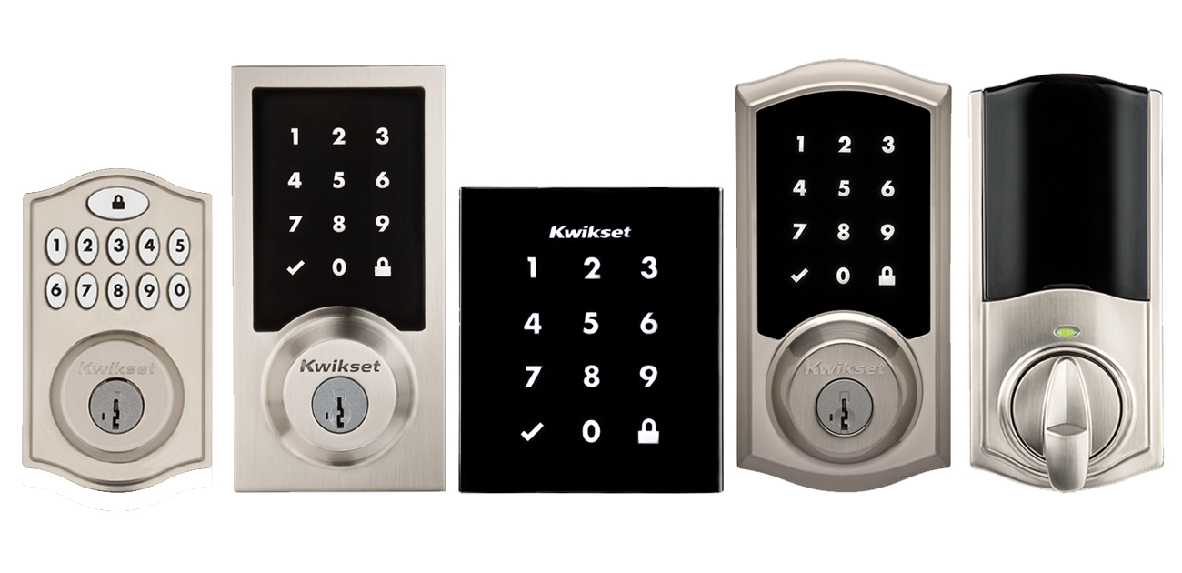

I have a physical disability, so the smart doorbell/lock is to allow me to see who is at the door on my phone, warn them I’m on my way but I’m moving slowly today, or even let them in from the sofa. However I want to have a physical doorbell still, like a smart lock that still has a key use (a bit like you can see in the image above).
This brings up issues with whether I have the right lock as part of my existing door (and as a renter I probably won’t be able to change the door), and whether I have a chime now (which is probably broken), and whether this is compatible with the smart doorbell I might buy, and whether that comes with a chime of it’s own. I think I’ll only be able to do a smart doorbell, but I just don’t know.

If you’ve chosen HomeKit as your platform, I’d wait a few months or so before purchasing a lock. There’s a new feature called HomeKey that allows you to use an iPhone and/or Apple Watch to lock/unlock a door using NFC. Schlage just announced one that should be coming soon. It also retains all the normal smart lock functions and I believe their model will have a physical key lock as well. Unless you have some type of 24” thick solid steel vault for a door, they’re all pretty standard. Take a pic of your door and current lock and post it so we can see what you’re working with.
