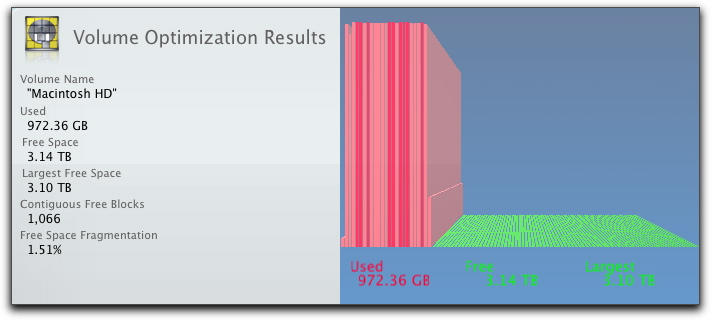

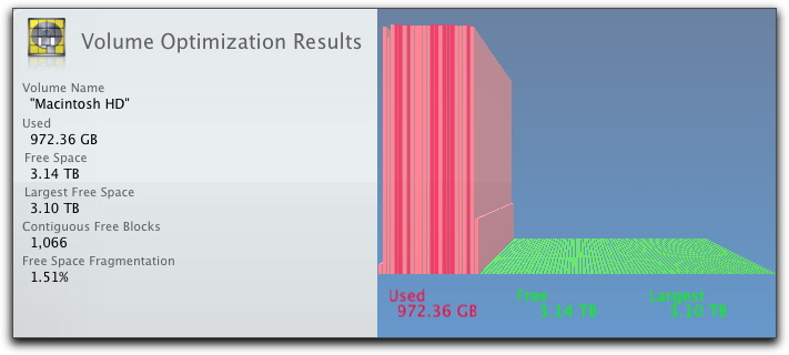

Here's my 4.5 TB RAID0 after about 5 or 6 months of heavy use and I've never defragged the volume. For files, a different application says that I have 7 fragmented files and all of those are >1GB avi files that were DLed by torrent. 😱
