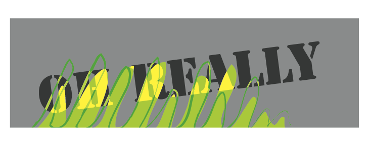

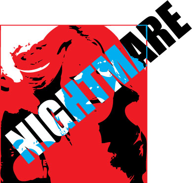

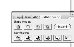

You mean like this...
You would be using the pathfinder tool in Adobe Illustrator...
Under Pathfinders...you would use the divide button. (The first one)
You can then ungroup the selection, and change the colors.
(Note: Just make sure that when working with complex items...that the paths aren't grouped when trying to divide another object with them...the pathfinder tool doesn't like that)

Thanks, but not quite.
For one, that's not negative if it's black the overlap should be white. That looks like a transparency. Second, you can't do that to a photograph like I did in Freehand. I appreciate it, though.

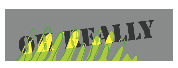

So, this isn't what you were trying to acheive?
(completely vector)

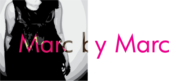

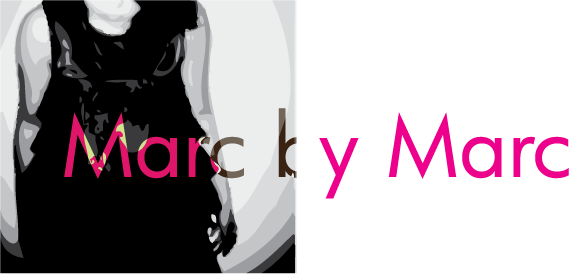

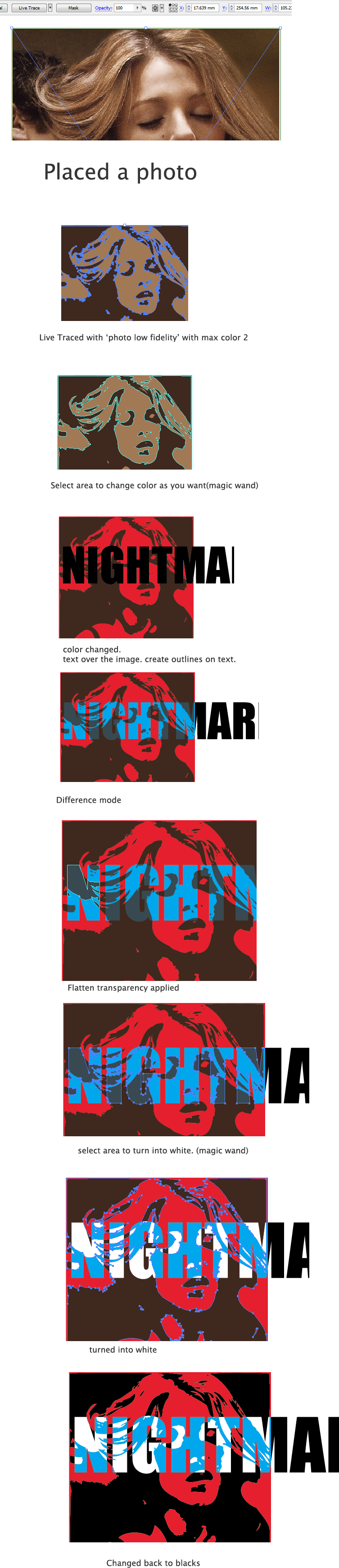

is this what you wanted?
if so, i first placed a photo file (illustrator cs3), and then live traced it to make photo as a vector image.
and then i typed some letters over the image, and created outline on text.
copied the grouped layer of the image as many as i needed.
select each letter with white arrow, and select the image as pressing shift so those two can be selected together.
cropped it with the pathfinder.
changed colors on the cropped area using white arrow tool and swatches.
(click the image i attached to see it larger)

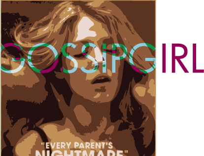

another example 😛
please click the image i uploaded to see it larger

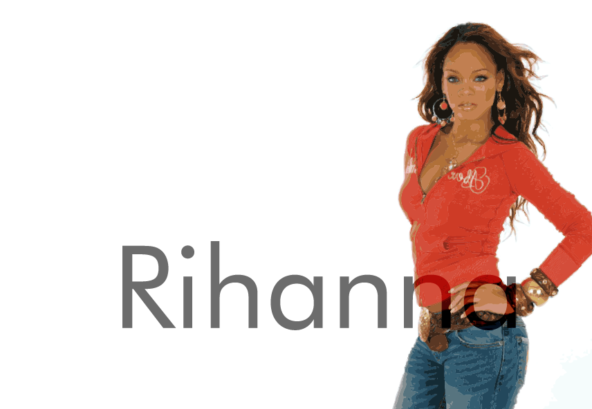

Could it be something with the blending modes in Photoshop?
Try messing with those, they might get the effects you are looking for.
Damn you beat me do it haha. Yah try difference mode, it will create the solid colour on white and then create the inverted colours effect when it interacts with others.

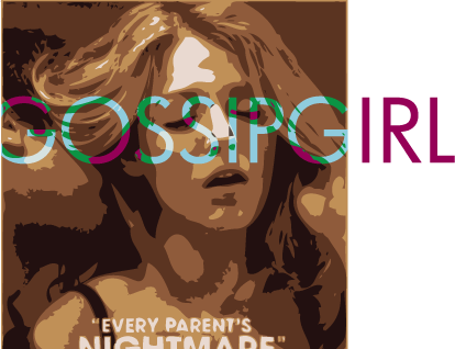

Thanks guys, but my problem with the difference transparency is that blacks don't turn into whites. It just turns black text into a gray transparency. Here's my example of what it does. What should happen is the text stays black on the outside and pure white on the overlap like a true reverse. Just like in my "the methods" poster.
Just a simple transparency isn't going to work.

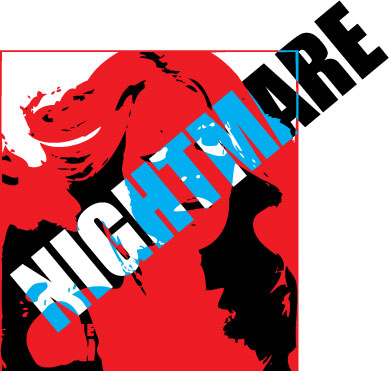

Edit: Okay, a simple applied effect doesn't work. You actually have to put more effort into it.
It does require applying a live trace to the photo, expanding the selection, and using the pathfinder tool.
I have faith that you can do this. Also, a note to make...you may need to use the pen tool on the more intricate areas to "cut up the text" and apply an effect to it.
On this example, I livetraced the photo (in illustrator)...created outlines from text...copied the text...cut the pieces from around her body...pasted in place (to get the text that wasn't overlaying her to show)
I'm sure there's a better way to go about it...but it's crazy busy today at work...and I need to get back at it.

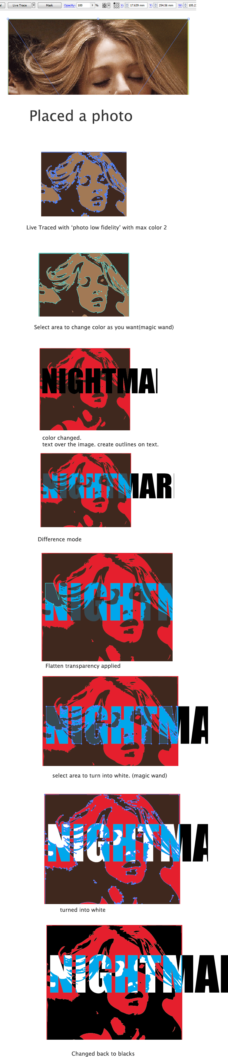

it's not exact same function occurs in Freehand you used in your poster but since you asked if there is in CS3 vector using program, i guess this can substitute if you want the effect in illustrator CS3.
1.place a photo, live trace it with 'photo low fidelity' and change max color to 2 (or as many color as you want), and expand.
2.apply colors you want to use to image using magic wand.
3.write a text over the image, and create outlines.
4.select those two layers (text and image) and use 'difference' mode on transparency. this reverses colors.
(i think you'v already tried this far, but having problem not getting whites over the black)
5.select black area( or the area colored same with the text) with magic wand, and chage the color to anyother.
6.go to object - flatten transparency
7.using magic wand, select the area which should turn into white but didn't. and change color to white.
8.change the color you've changed on 4. to black.
That's the closest to what I'm looking for. Thank you.
