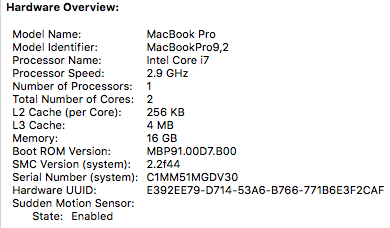

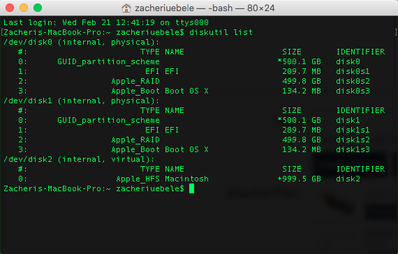

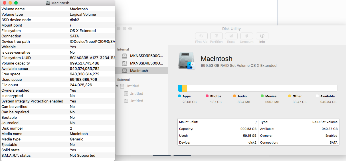

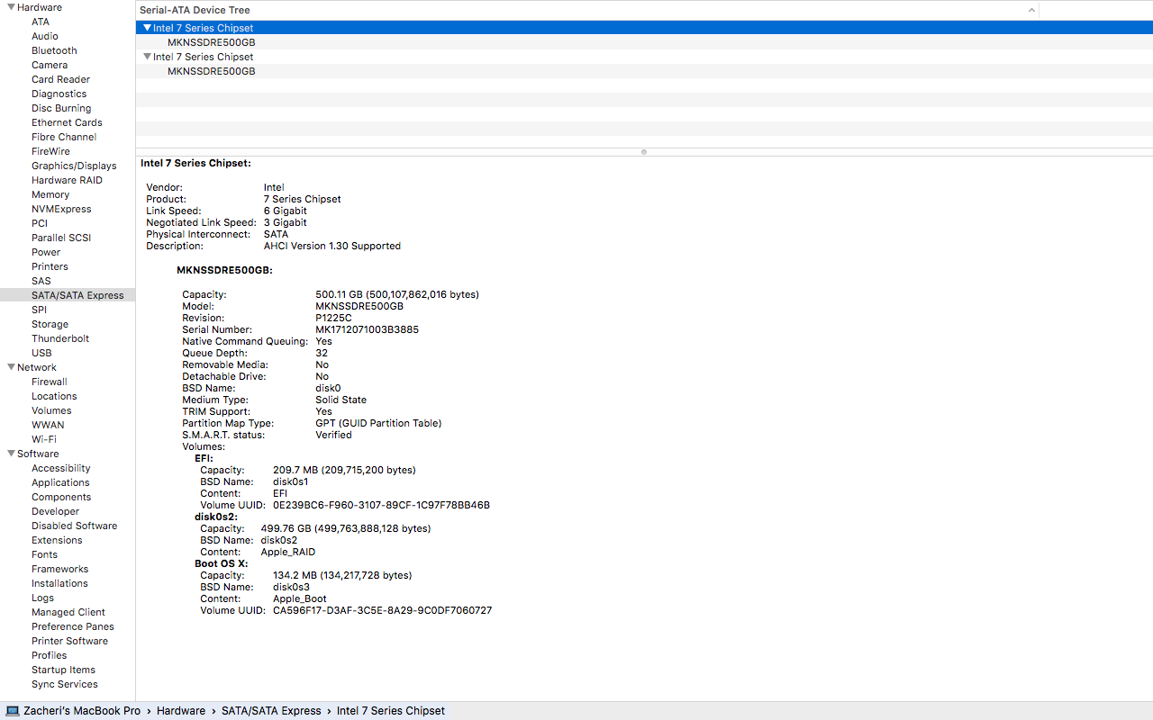

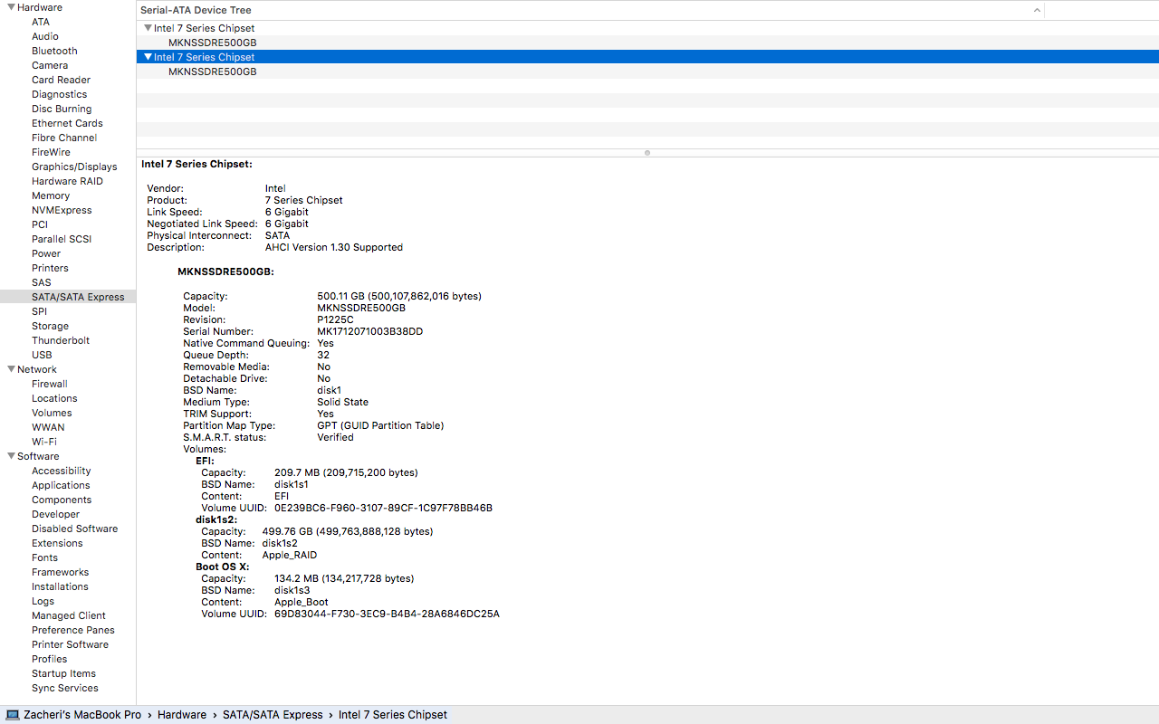

I'm running two SSDs in Raid 0 on my 2012 13" Macbook Pro using an HD Caddy and on one of my drives in only running at SATA II speeds and it's making my system only run at the speed of that SSD as it's bottlenecking the other drive due to RAID. How do I get my normal RAID speeds by fixing the negotiated link speed to 6gbps?

From a few posts I saw, disk0 is the HDD slot, disk1 is the optical bay. This may not be definitive. But I would try the HDD cable first. The OWC Data Doubler is just a bracket/caddy to fit a 2.5" SATA drive into the optical bay. The connector in the bracket has electronics in it so if it's not good, it may cause problems. OWC charges more for the Data Doubler than others so that's probably why it works when others may be hit-or-miss. But again, it's more likely that the HDD slot is the problem. I have a RAID0 setup in my mid-2012 MBP which I bought Apple-refurbished in Dec. 2015 (so a new HDD cable) with the OWC Data Doubler and it has the expected 6gb negotiated link speed for both SSD's. If neither the HDD cable nor the Data Doubler fixes your issue, you may need to switch around the SSD's to see if it's the SSD is the problem. But doing that, the RAID0 setup may no longer work so you would want to have an external bootable OS disk to see what link speeds you're getting. You should also be prepared in case doing the switch messes with the data on the SSD's so make sure to have a backup or two if you do that.

Fixed by replacing main HD cable!
