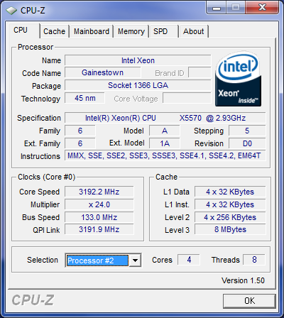

According to the aforementioned AnandTech review, these are the max turbo boost speeds... has anyone confirmed whether this feature is actually enabled and working on their Mac Pro?
According to Intel's white paper it may be somewhat tricky... someone may need to develop a utility to measure it... Any software developers in the house?

Well my W3520 2.66 under single core load only goes up to 2.79Ghz 😕

With the 2.66GHz X5550 anandtech are quoting 3.066GHZ (1 core busy) or 2.93GHZ (4 cores busy).
The 2.93GHz X5570 we all know Apple quote 3.33GHz and anandtech say 3.2GHz with 4 cores busy.
Anyone find any data for the W3540 2.93GHz Quad?
