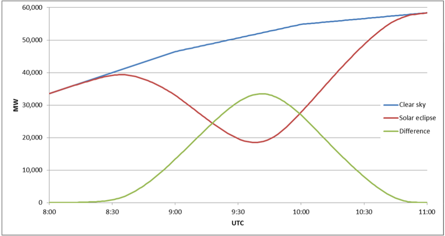

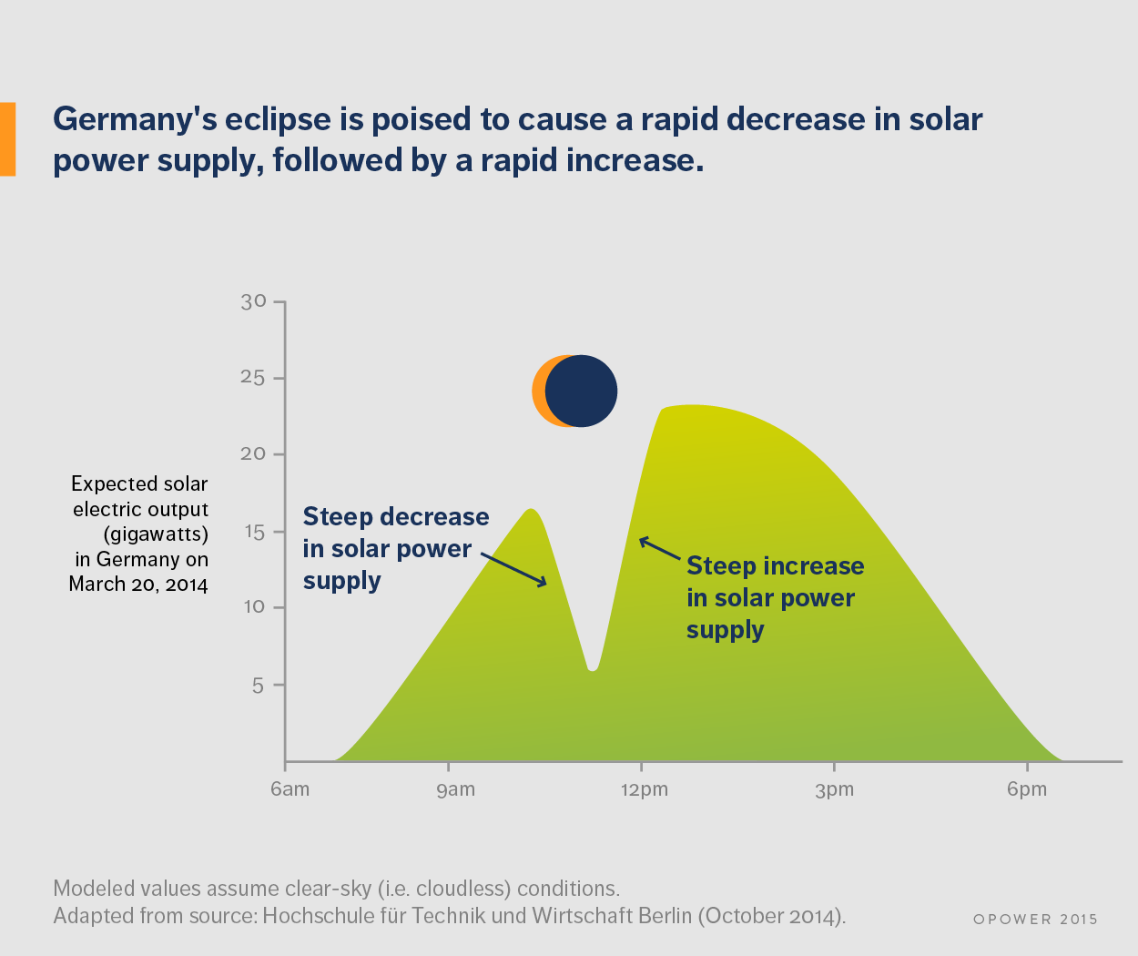

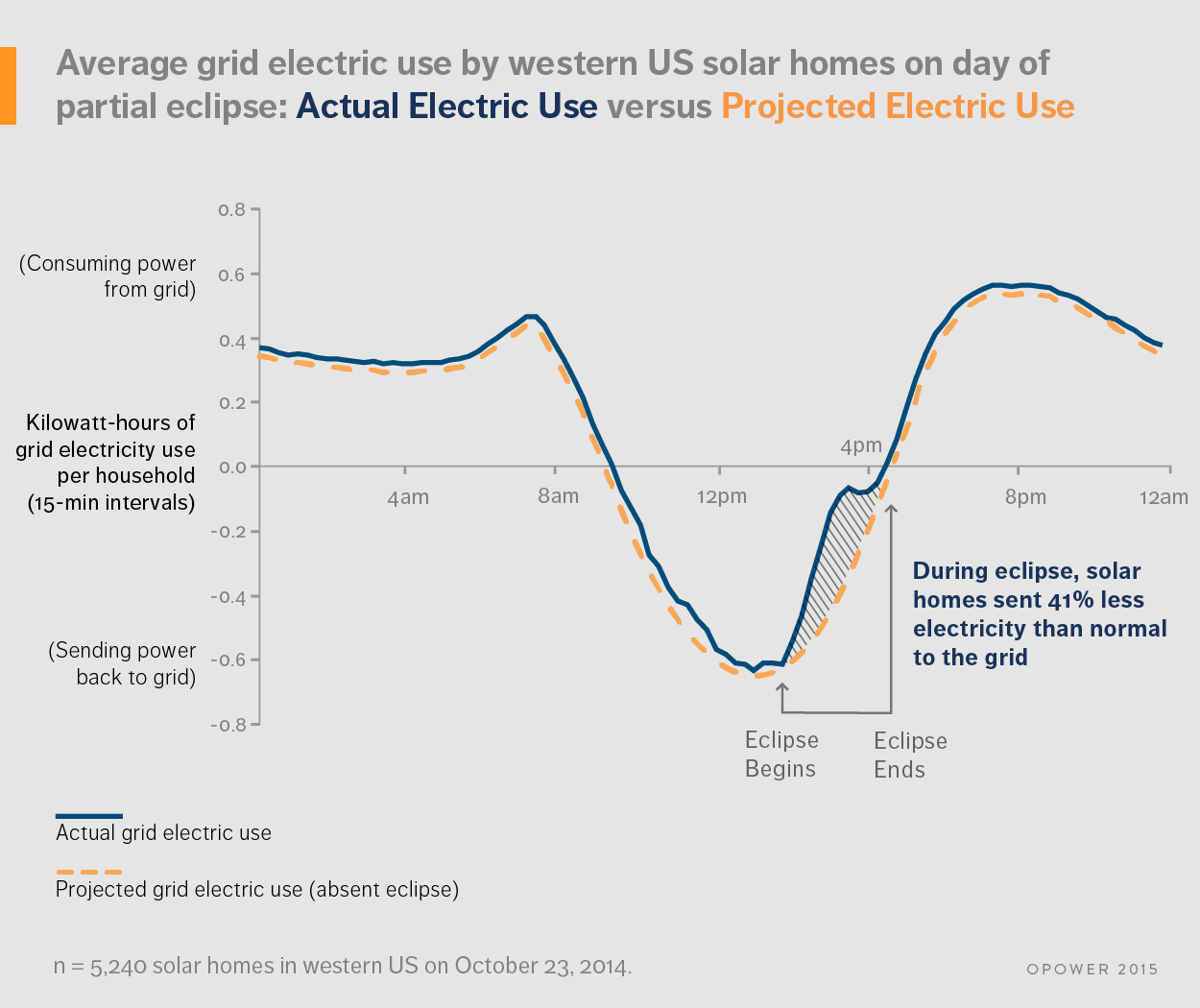

The last eclipse I watched, the street lights came on automatically. And no, the solar power generation doesn't just go down for the few minutes of the total eclipse but over a few hours, depending on how large the relevant electrical grid area is. Here are a couple of graphs from two articles:

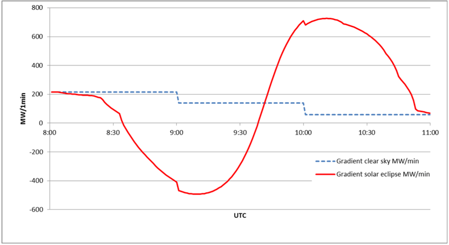

What also matters is the rate of change:
How much this poses a problem depends on many factors. Foremost probably the percentage of PV in the total electricity supply at the time of the eclipse (which among other things depends also on the weather, the time of day) and secondly how flexible the grid and other power sources are (including storage systems from pumped storage to batteries). If an eclipse hits an island that is not connected to a wider grid (eg, Hawaii), things get more critical.

The real problem is not the lack of sunlight but the rate of change of (non-PV) electricity supply needs. You never get such a coordinated change from sunlight to thick cloud cover over such a large area from normal weather changes. The rate of change (in decrease in PV electricity production in about the hour leading up to the total eclipse and the rate of increase after the total eclipse) is more than twice as fast as the rate of change during the normal daily cycle in the morning and in the evening. And daily PV electricity production cycle is partially matched by the daily demand curve, making the normal rate of change required from other electricity sources to compensate even less than that.
The good thing about an eclipse is that it is very predictable. The bad thing is that it needs relatively steep ramps from other electricity supply providers. Tweaking the demand curve to decrease somewhat in lock step with the eclipse reduces the rate of change provided from other electricity sources.
And if you are wondering how the U.S. ever made it through the eclipse of 1979, I ask you to ponder what percentage of electricity back then was supplied by PV compared to what percentage it supplies today.
