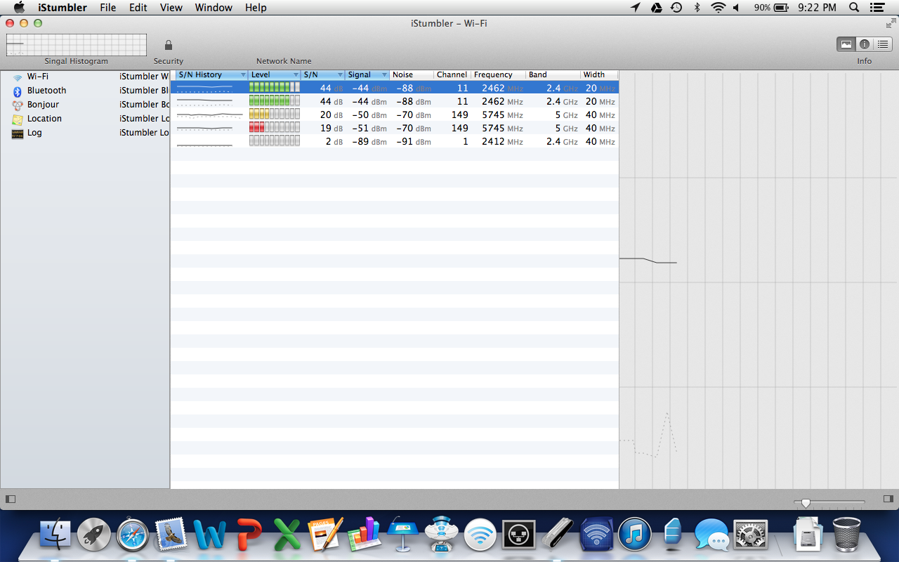

Try downloading the application iStumbler. The latest beta version is great and will tell you any networks that can be seen and what channels they are on. Within the same room of your router, you want the signal to noise ratio to be over 40.
Look at the network I highlighted. That is my AirPort Extreme and it auto selects. I am across the hall in another room and it is giving me 44 S/N Ratio.
