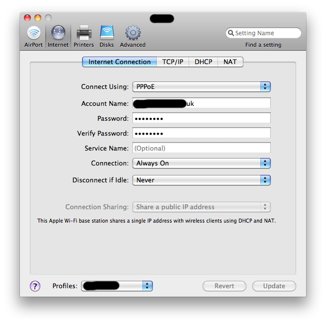

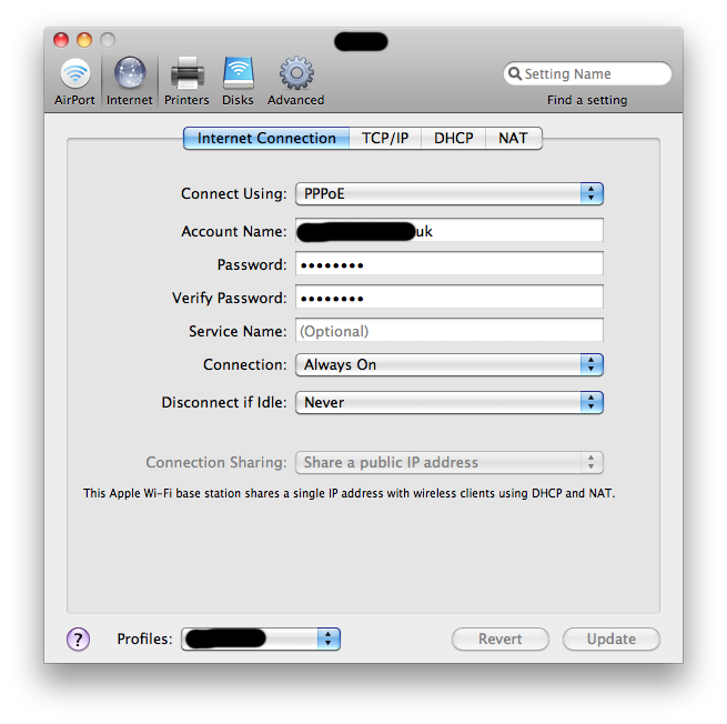

I'm on a different UK ISP now though, but here's my setting page from my Airport Extreme which is connected to my Netgear DG834G. Do you not have the same options?
Yep, that's pretty much exactly as I have mines set up.
