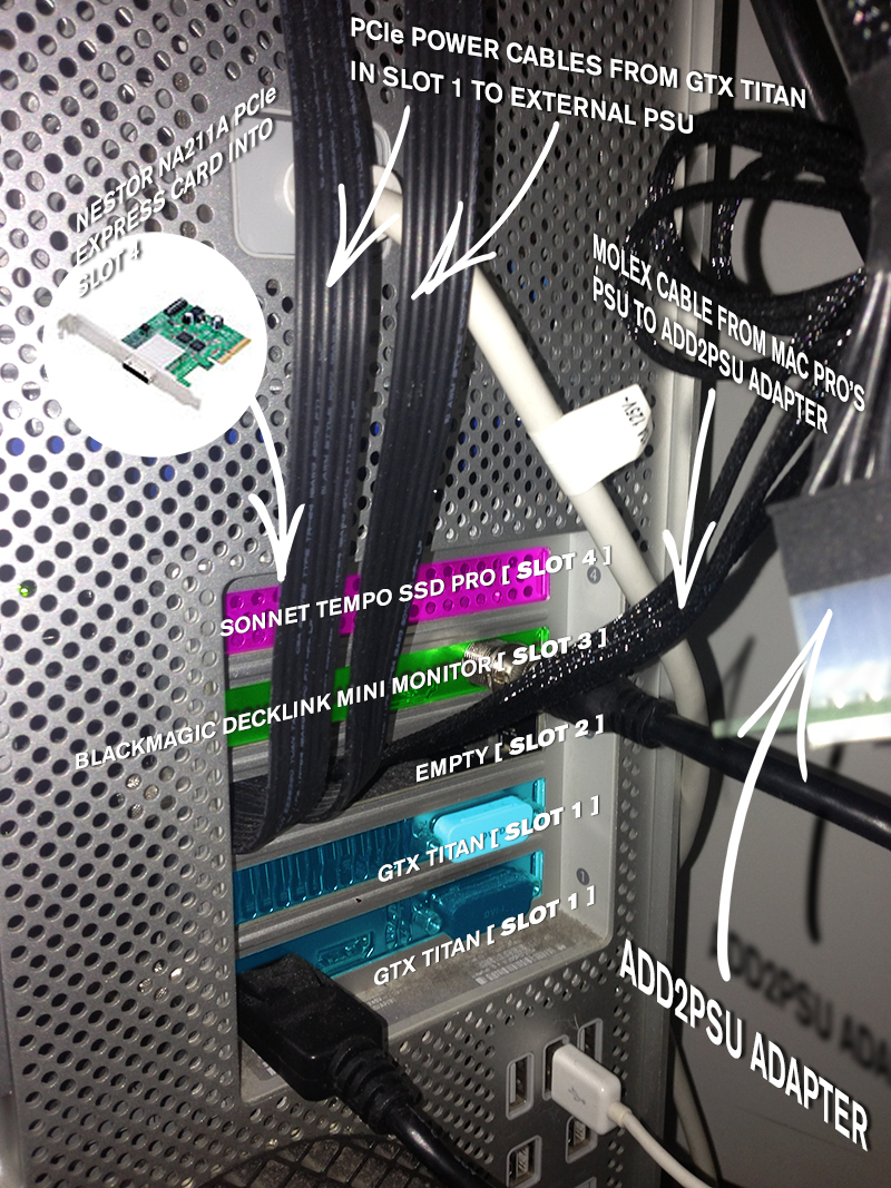

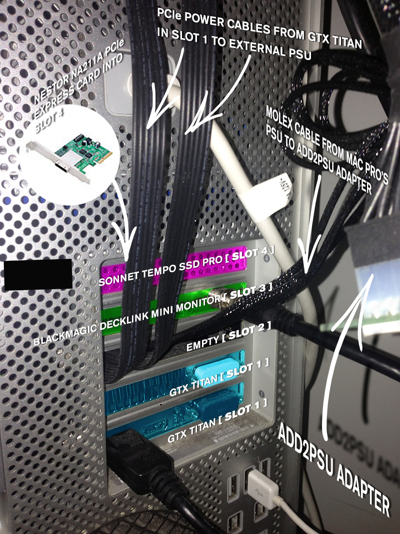

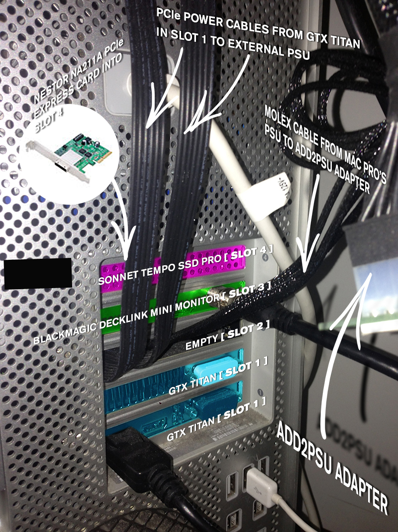

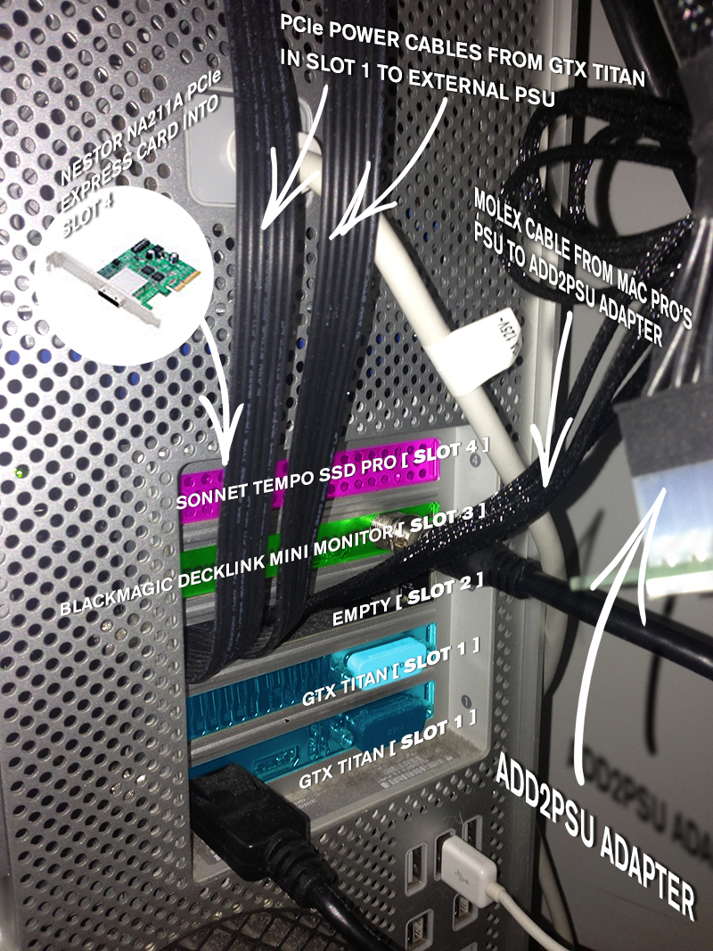

Hi Tutor (and other mod superstars!). Would be interested in your thoughts for this setup. Before I dive into the details, I've attached a photograph of my current setup.
The idea is to add a 2nd Titan into Slot 2.

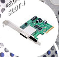

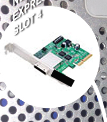

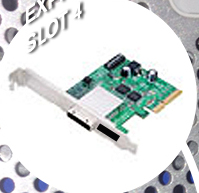

I think the NA211A could still be an option if I move all my other PCIe cards (Decklink Mini Monitor and SSDs) out of my Mac Pro and into the PCIe enclosure. The problem is, I currently have PCIe power cables and a Molex cable (running from the internal Mac Pro PSU) passing through an open PCIe slot. If I install both a 2nd internal Titan and the NA211A PCIe express card, that leaves no open slots to run my PCIe power cables (for both Titans) and the Molex cable out out of the Mac Pro.
Now I know you're a hardware mod genius and was wondering if you had any ideas on how to modify the bracket on the Netstor PCIe express card to pass through the PCIe power cables and the Molex cable. Possible?

Here's my 2 cent suggestions: 1) Determine whether the bracket is removable and whether you feel comfortable doing so. 2) Size up how much of an opening you'll need to pass the cable bundle by taking the total cable girth and comparing it to how much of an opening you'd have if your cut a bracket about where I've blacked it out in the photos , below. I assume that the bracket is secured to the back of the card, like most are, by two screws. I suggest you keep that protection intact; so only consider cutting a bracket below the bottom screw to preserve the bracket's ability to stabilize the card from the top. 3) Should you determine that you can remove enough of the bracket at the bottomnto allow passage of the cable bundle, then buy a second (replacement) bracket before cutting begins (you never know early enough when you might need the card to be in factory appearance). 4) Next make the cut and be sure to smooth down the edges with a fine grain sand paper. 5) Make sure that the top of the bracket is always securely held down after installation.
I. NetstorCardPCIeHackA provides the greatest opening, but does not provide additional support at the base because the bottom of the bracket is completely removed.
II. NetstorCardPCIeHackB provides the an opening that may or may not be large enough (that's for you to judge), but does provide a little additional support at the base because only one side of the base of the bracket is cut.
III. NetstorCardPCIeHackC provides the smallest opening, but does provide more support at the base than the other two options. It is, however, the more complicated cut because all of the cuts are in the interior of the base of the bracket.
IV. MacProHack is what I recommended to you earlier to pass the BoosterX5 cables out of the back of the MacPro.
You may have to magnify the images to better see what I'm getting at. I've got systems with all of these hacks. If my systems could name me, they'd name me, "Jigsaw."
Thanks for your suggestions Tutor. Which model of Dremel saw do you recommend for NetstorCardPCIeHackA, NetstorCardPCIeHackB, and NetstorCardPCIeHackC?
Also, what about taking the card somewhere to be laser cut? Expensive and even possible?
My Dremel is model 300i and for working on my MacPros I use and EZ Lock 1 and 1/2 in. circular Metal Cutting Blade.
That sounds like a wise, feasible course of action. But since I do my own mods, I don't have a good feel for 3rd party pricing.
