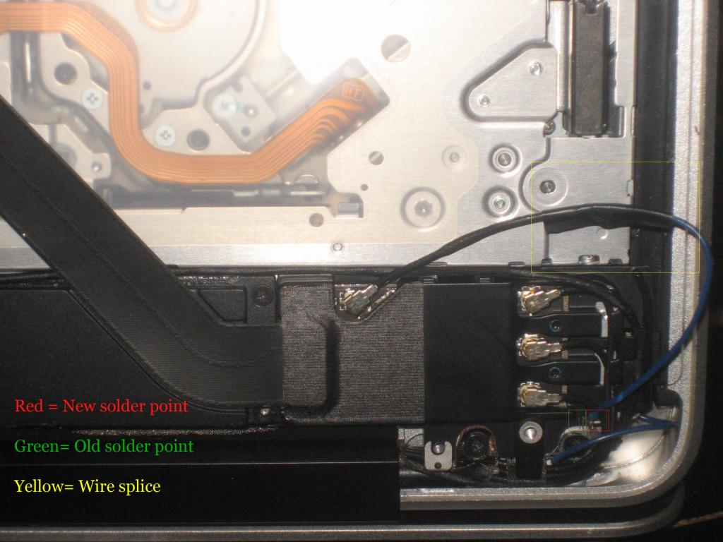

I found one wire broke from its solder point. I re solder it in place right next the old connection. The original wire was too short so I spliced in a piece of the same grade of wire. Still does not work. Any suggestions?
Here is a picture to describe what I am talking about.
