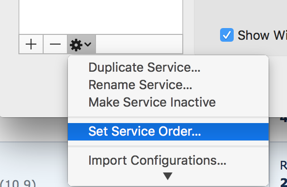

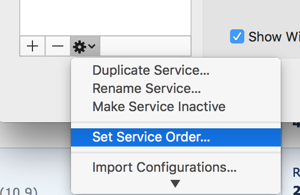

I have no idea what to do with network from system preference. I put automatic mode for location but only wifi works while thunderbolt to ethernet is not working. It did work if I use 'Assist me' to create another location. But now, thunderbolt to ethernet is completely not working at all. Wifi is slower than the ethernet and I need to find a solution. What should I do?
Do you know for sure TB ethernet is not working, os could it be that the wifi is just taking precedence over the ethernet connection. To make the ethernet take priority, go to the Network pane in System Preferences and click the little cog at the bottom. Then click set service order, then drag ethernet to the top and save.
Does that help?
Does that help?
