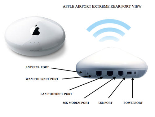

    So you have the AirPort Extreme Base Station, displayed in the following image?
    [​IMG]
    And you have some kind of modem?
    As far as I have experienced with my own AEBS, the AEBS works as a router and uses PPPoE to dial via the modem into the internet and giving all the clients connected to the AEBS access to the internet.
    But if you are putting a switch between the modem and the AEBS to connect the MP to the modem, only one of them can be connected to the internet, as not two devices can dial up* on the same modem.
    And the AEBS also has three LAN ports, which makes a switch redundant in your situation.
    Or do you have this older model?
    [​IMG]
    It has a LAN port too, which can be used in the fashion you want to without the need for that switch.
    Or am I still on the wrong track with your setup?
    * I use dial up as that is what it does, it dials a number provided by the ISP and establishes a connection.

    ok, problem solved.
    I do, in fact, have the older model. Plugging the cable directly into the one ethernet port has fixed my issue.
    Thank you so very much for your help!!
