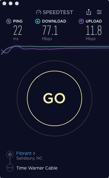

I installed speed test for my mac & iOS devices. When connected to ethernet I only get about 80 Mbs download speed (on the Mac Pro in my sig).

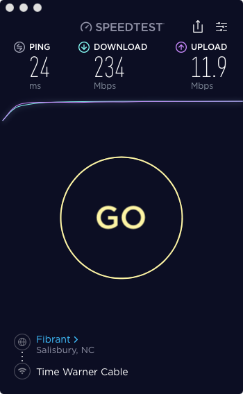

When I connect any of my devices (including the Mac Pro) to 5 Ghz Wifi, I get 220 Mbs download speed.
It's a real difference, not just a fluke, the speed is obvious on everything I do internet wise.
Is it normal for the ethernet to be that slow on a 200 Mbs connection? If not, what can I do to fix this?
I'll add a pic for the ethernet speedtest later if you need to see it with your own eyes.
Sounds like your Ethernet connection is linking at 100Mb (i.e. Fast Ethernet). Is your switch gigabit capable and is your cable 8 conductor?
You can check your Ethernet speed on the hardware tab of your Ethernet properties.

It shouldn't be related to two connections. You can check the connection speed in the Hardware tab of your Ethernet settings on your Mac.
If it's linking at 100Mb but the cable modem supports gigabit, try another cable. To support gigabit, the cable must have 8 conductors.

When you select ethernet in network preferences, and go to the hardware tab, what is the speed? Macs will auto negotiate 10\100\1000Mbps speeds with the router or switch on the other end of the cable. if the router or switch is 100Mbps, or the ethernet cable is Cat5 (but not 5e or 6), you may be maxing out at 100Mbps. If so, try 5e or 6 cable, and verify the router or switch ethernet ports are 1Gbps.

Okay, so I’ve wasted $20 on a new Cat6 Cable but here’s what I found...
My cables were fine (Cat 5e). The problem is that the ethernet1 port on my MP only connects at 100-Base and the ethernet2 port connects at 1000-Base (Gigabit) speeds.
I have tried every combination of cable/port connections, and that port on my MP will give me no more than 100-Base speeds. So I guess the port is damaged. Even if I force the connection speed manually, it still doesn’t increase download speeds.
So, I changed the service order, and rename the port services to reflect my preferences (port 1 was renamed to ethernet 2, port 2 was renamed ethernet 1). Now my properly functioning port is called Ethernet 1.
The eithernet connection is now just as fast as the WiFi, but I am a little upset that my MP now has a damaged port.
I suppose this can’t be fixed without replacing the main board?
