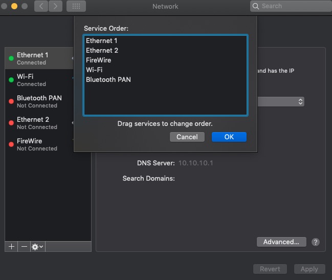

I'd check service order settings in your network preferences, my guess is that when you turn on WiFi that becomes your default route (which you probably don't want). Click the little gear/sprocket to see set service order in the network prefpane, move Wi-Fi down in the list.
Reactions: Juicy Box
Nope - the order makes absolutely no difference. If WIFI is enabled, the ping times are drastically increased.

I can confirm this weirdness on my Mac Pro. Even if I re-order the NICs to be above the WiFi adapter, the latter takes precedence over the former for some oddball reason. I tested this by logging into one of my local servers and could clearly see the IP address from my incoming connection: the Mac's WiFi adapter. Not its NIC.

Looking at my routes....
WiFi off:
Code:
Destination        Gateway            Flags        Refs      Use   Netif Expire
default            10.10.10.1         UGSc           48        8     en0
10.10.10/24        link#9             UCS             5        0     en0      !
WiFi on:
Code:
default            10.10.10.1         UGSc           54       10     en0
default            10.10.10.1         UGScI           2        0     en2
10.10.10/24        link#9             UCS             7        0     en0      !
10.10.10/24        link#11            UCSI            1        0     en2      !
WiFi is en2, first wired NIC is en0.
I see what I was doing wrong: I was letting the wireless connection grab a DHCPOFFER, which includes a default route. But my internal LAN interface is NOT accepting a DHCPOFFER, it's set manually. And it doesn't have a default route (my external NIC does). What that means is that the wireless connection was preferred over the internal LAN interface, even though I told it not to be.
The fix was to manually set the wireless interface's IP, and remove the default route from it. That set it way down in the priority list, and the Mac started using the private LAN interface for all of my internal traffic like it should.
