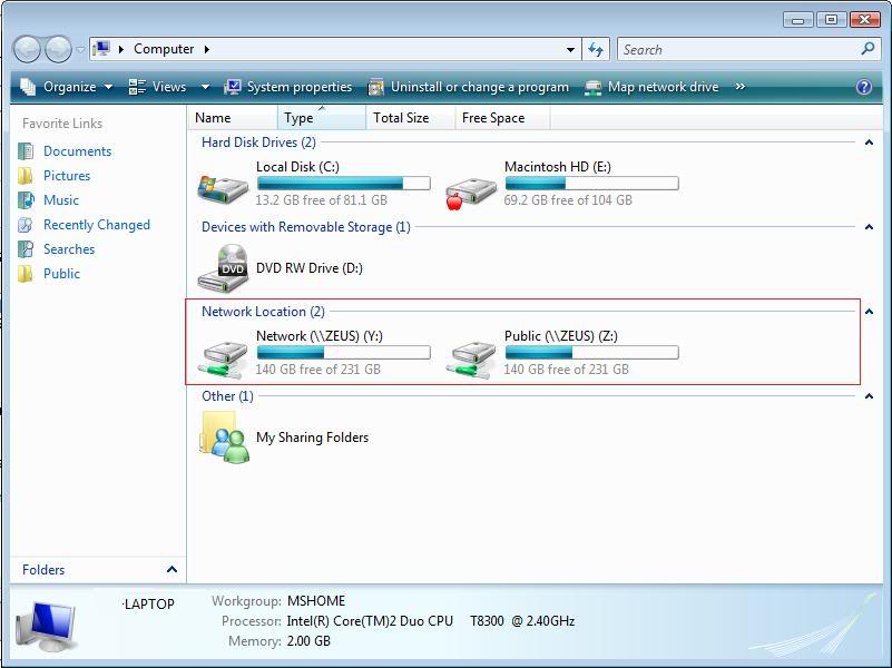

If you look at the red box,
This is the location where all my music is stored on my NAS
Z:\Music
With out a network drive its
\\MSHOME\Zeus\Public\Music\
I'm trying to re-create the Z:\

You can't do that exactly. What you CAN do, though, is go to Connect to Server, type in:
Code:
smb://MSHOME/Zeus/Public
...as the server to connect to, then click OK. After any authentication, a drive will mount on your system, called Public. You can then use this to reference files.

The NAS is effectively a standalone file server called Zeus. The path to your music files would be \\mshome\zeus\public\music. Z=\\mshome\zeus\public.
