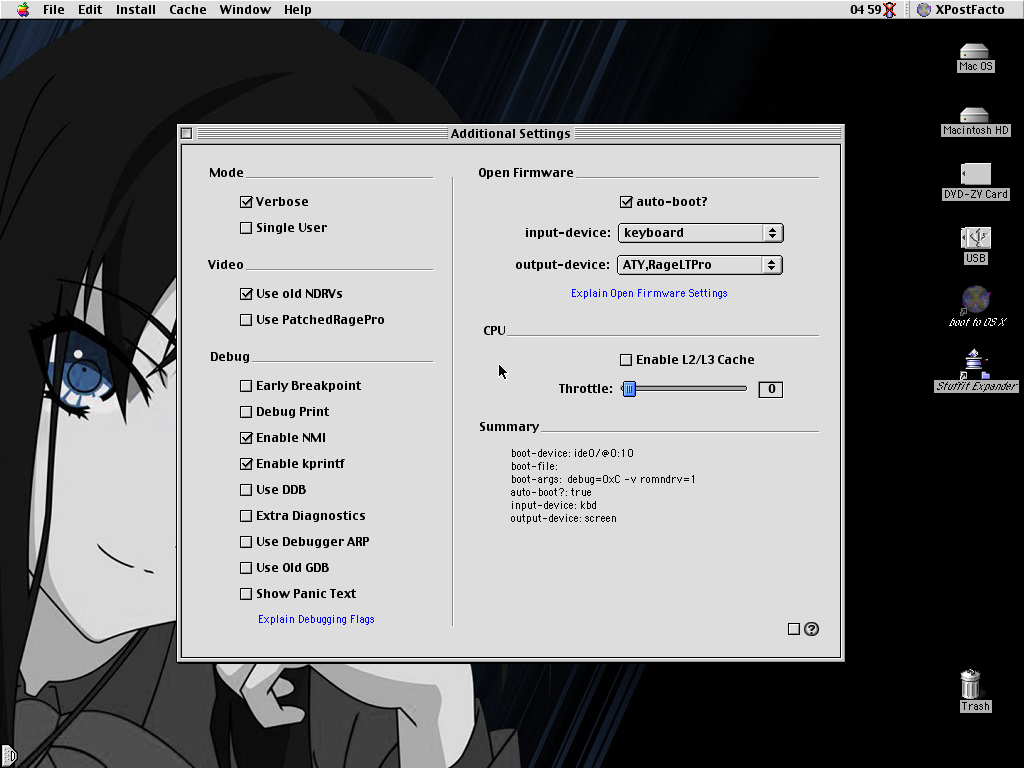

With the PDQ, there are quite a few requirements:
+ drive must be 128GB or less
+ drive must be formatted from OS 9
- formatting from OS X, even with OS 9 drivers, wouldn't boot
+ OS X (system) MUST be in the first 8GB of the drive
- if the partition extends beyond the first 8GB, it may boot, but will eventually fail to boot as the OS moves files around in the partition

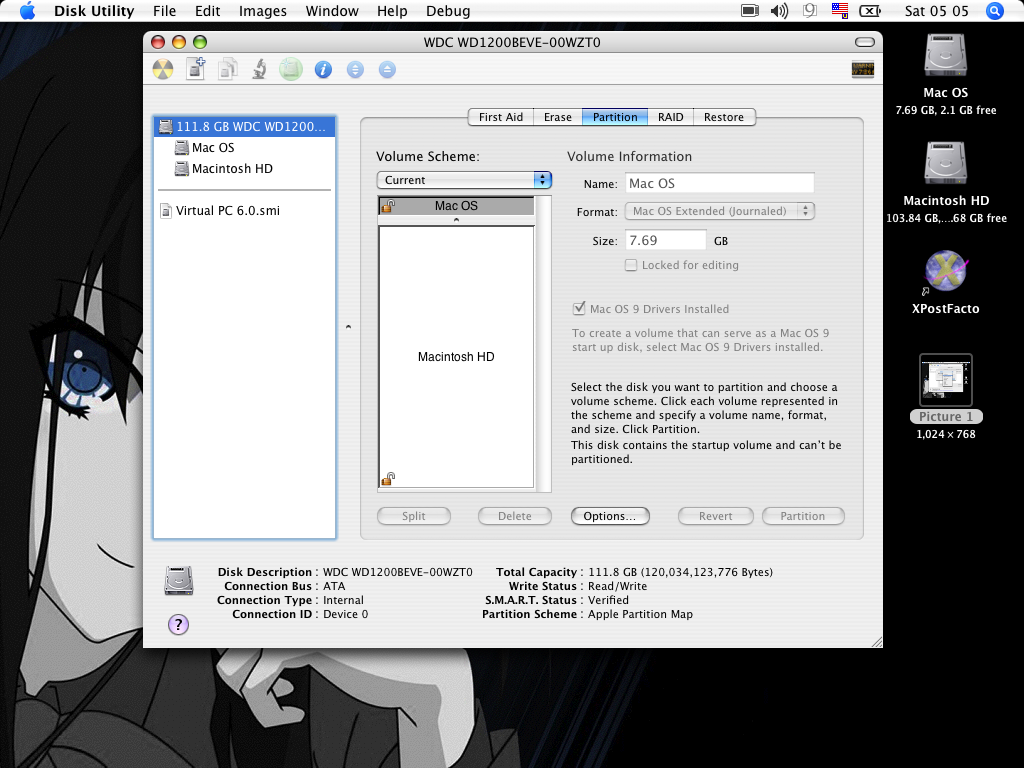

I worked around most of this to have a reliably-booting 10.4 by:
+ using a 128GB drive
+ format in OS 9 with 7.9GB partition and 120GB partition
+ install OS 9 to 2nd partition (120GB)
+ install 10.4 to 1st partition (~8GB)
+ from another OS X (could be installer), move /Applications and /Users to 2nd partition (120GB) and make symlinks back to 1st partition (8GB)
From there it is just using XPostFacto to switch between OS 9 and OS X.

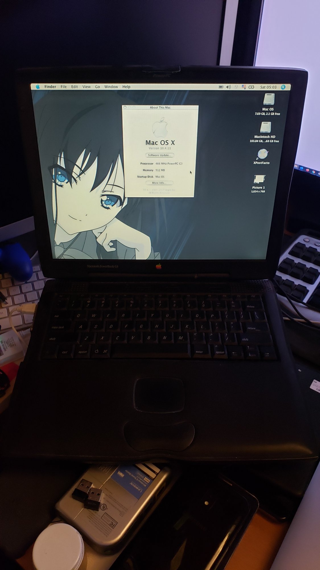

So it will stay with Panther. It as 384Mb of ram.

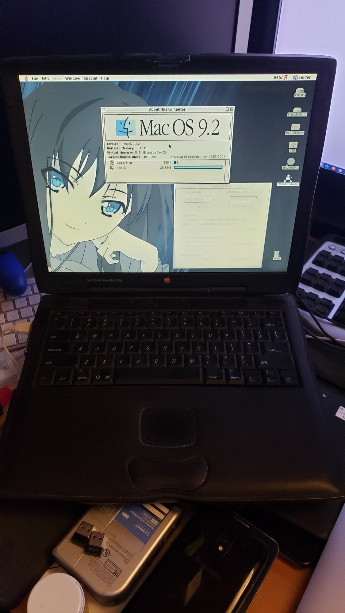

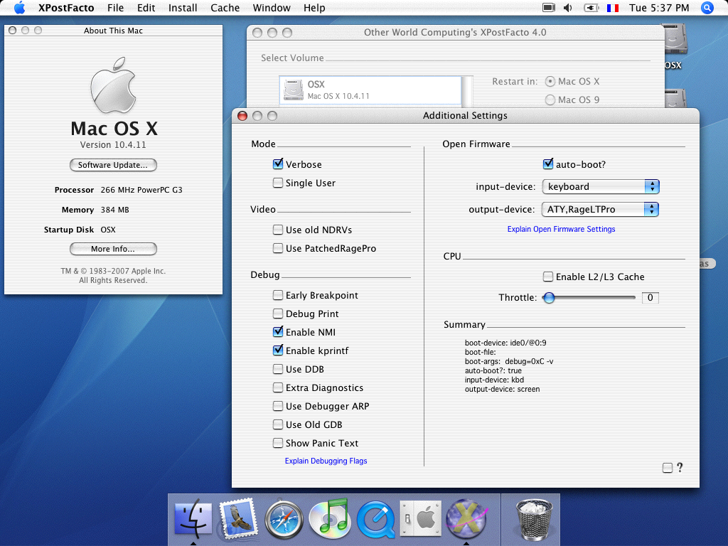

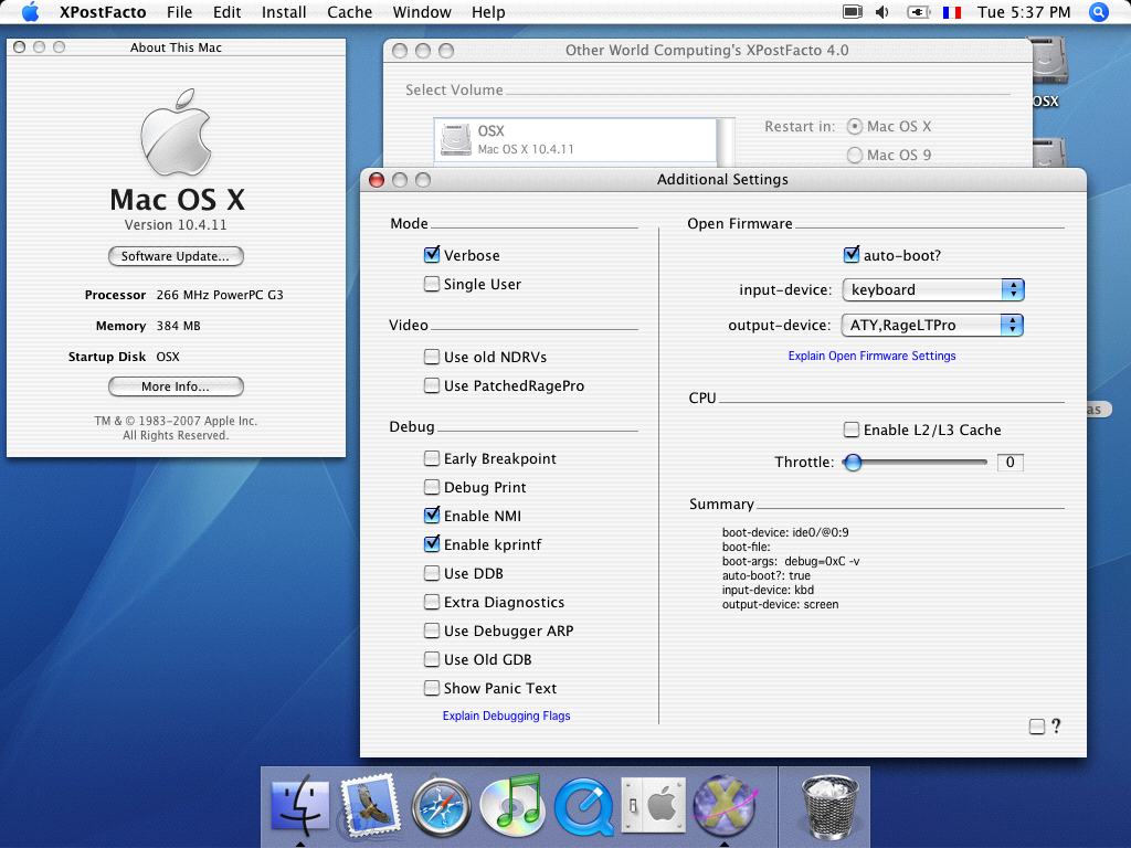

Gave me a good reason to dig out my PDQ, and it seems I had installed OS 9 in the first partition along with OS X.
Reactions: galgot
Nice .
Now that makes me jealous... Why can't i have Tiger purr fine on mine :/
What is that "466 Mhz power pc g3" ? Upgrade card ?
Maybe will try again with another HD.
Thanks ! Will definitively try again with these setting and another HD.
Maybe it is some of the XPostFacto options? I didn't have much success with the PatchedRagePro option, and without the NMI/kprintf it would sometimes just freeze on boot. The caviat is that I get to see all the debug text during boot, but at least it boots correctly every time, so I can live with that.
Reactions: galgot
Today, I used yet another 40Gb HD, installed it in a Pismo. As this PDQ doesn't want to boot from 10.4 CDs now...

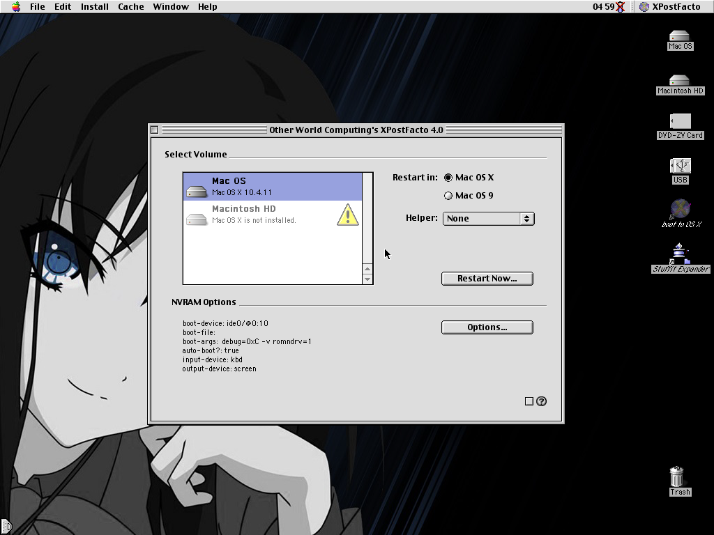

Made 10.4 install on the first 7.8 Gbs, then 9 on the second partition. Moved the HD into the PDQ, booted on 9, installed XPostFacto with your settings. Booted on 10.4 :)
Ok this is the first step, now I want to update to 10.4.11, and usually it doesn't want to boot after that.
So next step is removing the HD, making a complete exact image using dd on my MBP, so I'm sure I have at least a bootable 10.4 *period* that I can image back to the HD if it doesn't want to boot once the PDQ is updated to 10.4.11.
What an exciting life...
I WILL HAVE THE LATEST TIGER ROAR ON THIS !#ù** PDQ ! FOR GOD SAKE !
Success :
So I used your settings to update to the 10.4.11 combo online. Worked fine and rebooted fine. Second update was Quicktime and Safari, update went fine but reboot stuck looping in verbose mode. Rebooted in OS9 , unchecked "Use old NDRVs", and rebooted fine in Tiger. Then did all the following updates that doesn't need reboot, all fine.
Just, at one point I left the PowerBook for a few mn, and it went to sleep and wouldn't wake.
it apparently doesn't like sleeping at all, have to hard reboot in OS9 to reselect OS X or startup.
So I've set it to never sleep...
Anyway, thanks for your screenshots/settings e all. Will see how (and how long) it runs with a fully updated Tiger now :)
