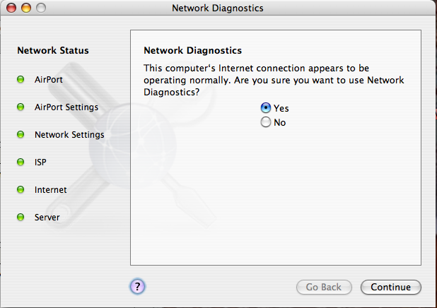

try another cable, try connecting through airport wireless, or try running network diagnostics...it will tell you exactly were the problem is.
--Eric
You could try using ifconfig in the terminal to view to MAC address. Try it once, and again every few seconds to see if it changes.
You don't ever have to mess with the terminal to check your internet connection, just run network diagnostics. Macs were made to be easy to diagnose.
Telling someone to enter commands in terminal is a waste of time.
Look at this picture, if there is not a green light on the diagnostics, that is where the problem is.
Take it from a Mac user of 25 years.
--Eric

My problem is that for whatever reason, Network Utility is losing the mac address for a split second and saying "not available", then it snaps back.
It's doing it for not only the Ethernet adapter, but for the Firewire network adapter.
If it were a cable problem or a problem with the port on the router, you would think A) the only thing that would change is the "active/inactive" piece of the network utility screen, not the hardware address which should always be connected and B) the Firewire port shouldn't also exhibit the same behavior, telling me it's doubtful it's a faulty piece of hardware.
The interesting thing was the internet connection didn't drop during that period.
