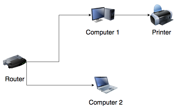

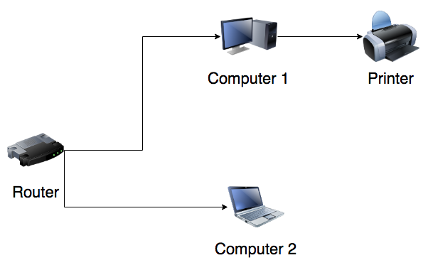

So, here's my current setup:

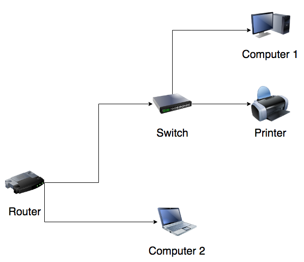

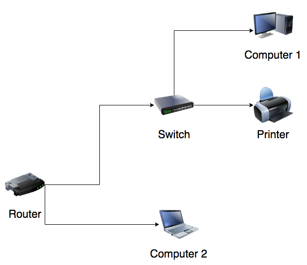

But with a switch as you suggested, is this the correct connection (assuming the goal is to print (it's a networking printer of course) from either computer, regardless if they're both switched on or not):

So, here's my current setup:View attachment 703412

That is correct. If the computer can successfully use the cable in the wall, there's no reason a switch should have any trouble.
Yes. The laptop will be able to access the printer when the tower is shut down.

In case it wasn't made clear, what you want is a switch. The Ethernet splitter you referenced would not work like you think it would. You would need a split on the other end of the ethernet run (ie. near the router). The purpose of this splitter is to run two ethernet runs along a single Cat 5(e) cable. It is works on the principal that typical Cat5e cabling only used 4 wires (2 Pairs) of a the 8 wire (4 pairs). The splinter uses the unused pairs as a 2nd run. However, it is only useful if you CANT run more than one ethernet drop to a location and you don't want to use a switch.
As other said, go with a switch.
