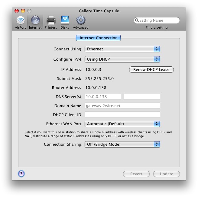

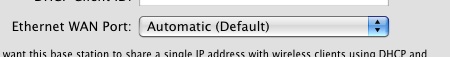

you need to have a look at the WAN port. (see pics below). see what that is set to, most likely default.

being on automatic should be fine. you could change it to a different speed if you wish but it wouldnt do anything. the main thing is that its turned on, because that means it will be giving away things.

if you look on the pictures that i supplied above, you will see that mine has
Configure IPv4 Using: DHCP
All the addresses below that cannot be changed, so therefore its fully DHCP.
However, notice that the DNS server and router address is 10.0.0.138? that is my modems address and my airport is getting an IP from that, which is rather annoying because it has to be the crappy common IP from the router.
uumm just post a picture of the same page that i supplied above if you wish. you can take a picture by hitting :apple: + Shift + 4, pressing the space bar and then clicking on the window you want to take a picture of.

ok that looks perfectly fine to me. im just hoping that an issue isnt arising that the two parts of the house are connected by a different power source/line. i have no idea about electrical house setups but from what i have read it should just be a plug and play type system....
