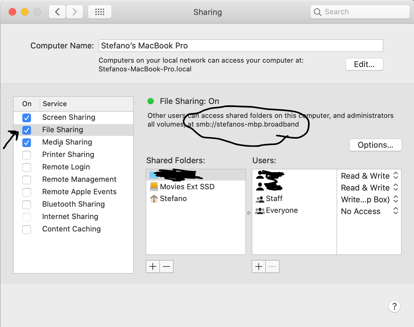

***Ignore the URL you see on the mbp***
On the Mac you want to access (the iMac?) go to System Preferences/sharing and tick "File sharing" and "Media sharing" (This is sufficient for what you want to do).
If you click over "file sharing" on the left of the window, this writing will appear to the right: "Other users can access shared folders on this computer, and administrators all volumes, at smb://name-of-your-computer.broadband" Make a note of this address (the format might be different). This is what you need to use on the iPad to connect to this computer.
Normally this name has no spaces and no special symbols other than the dash -
On the iPad, use the address above as the server address in the Files app.
On the next screen select "connect as: Registered User"
It will ask you for a Name and Password, these are the credentials you normally use on the iMac to log in.

It worked. Thanks so much!!!
only thing that didn’t work was the media sharing checkbox was greeted out so I could not enable it, though I can still double click on video files and watch them, so I am not sure what the Media Sharing option does.
