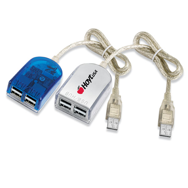

The drives have USB as well, but how can I connect both drives when the routers only have one USB port, and I can't daisy chain the drives via USB.
won't that make the drives slower over the network? I'll be streaming 1080p video content.
There's a theoretical bottleneck if you're accessing both drives at the same time, but if the drives are USB 2.0 and you have an ethernet connection to your router, you should have pretty good performance.
If your connection to your router is wireless, then that will be your bottleneck, and it'll be noticeable with a single drive, regardless of whether you use a hub.
