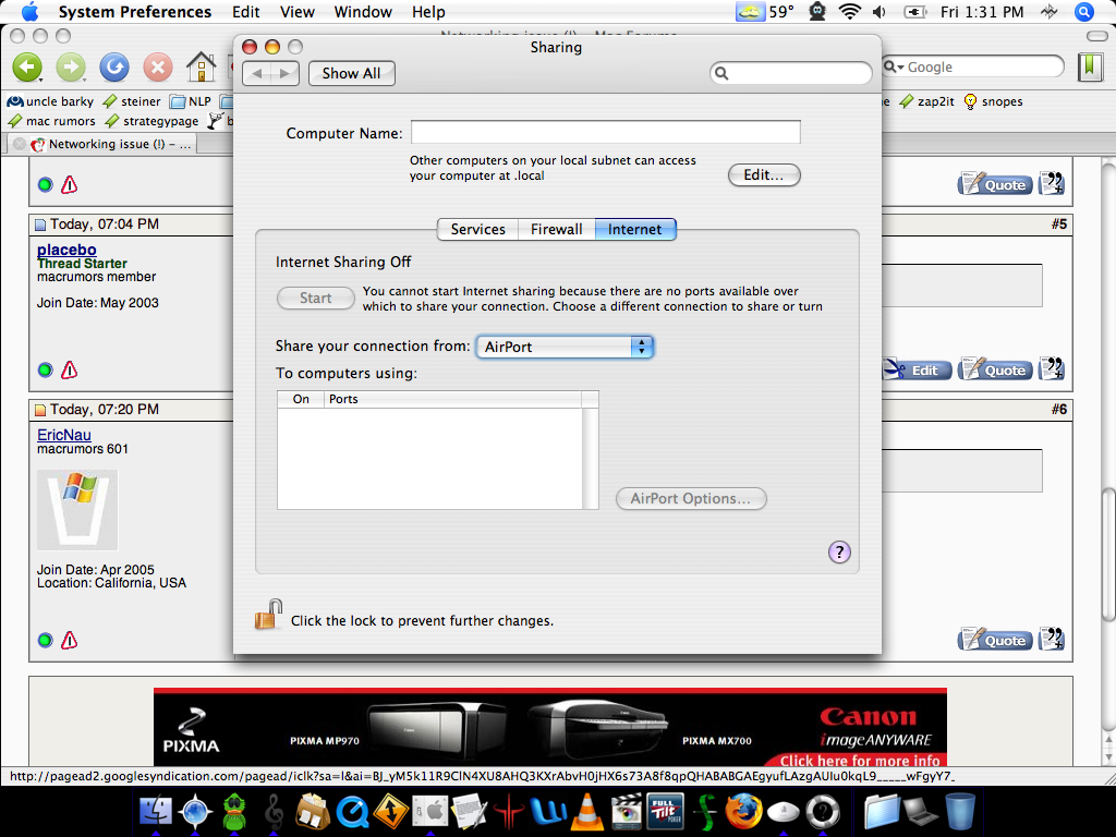

Here's what I found.. I can't even select Internet Sharing:
You need to go to Applications > Utilities > Airport Admin Utility.
Then follow the directions I posted earlier (keep in mind, there may be slight differences between my system and yours).

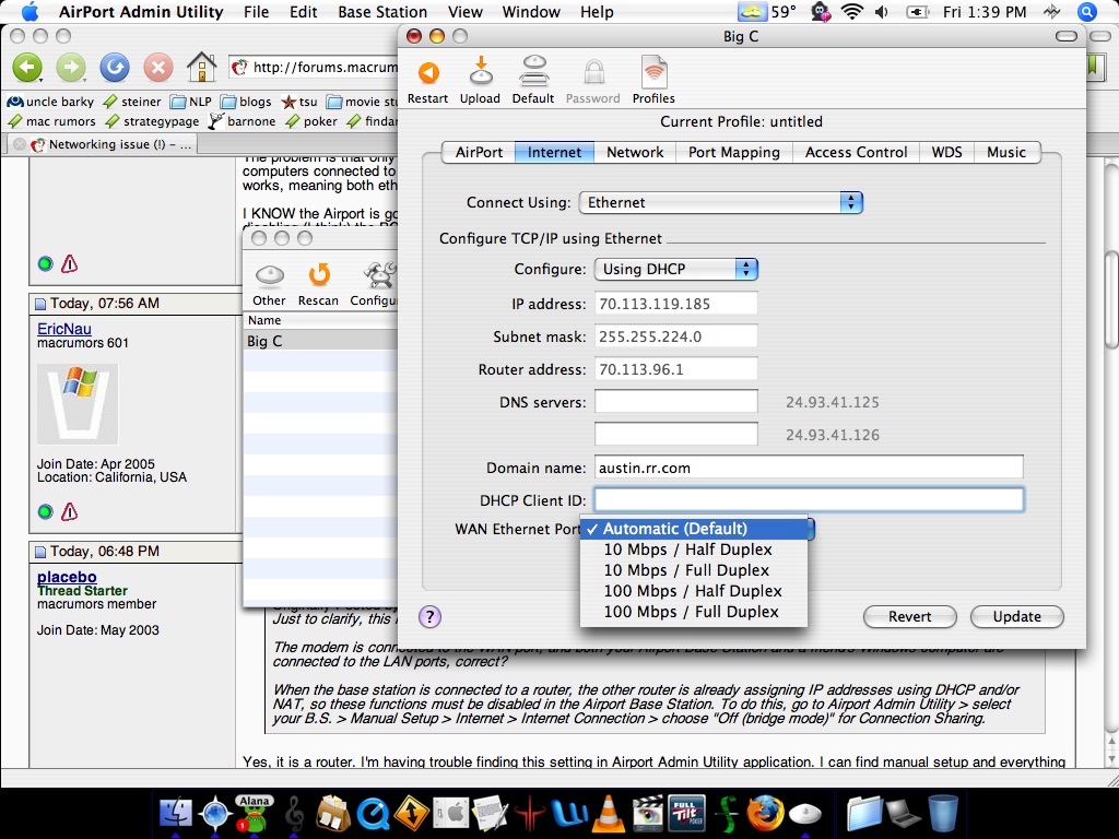

Here's how far I got.. there is a Manual option but it doesn't give me any sort of connection sharing option:
