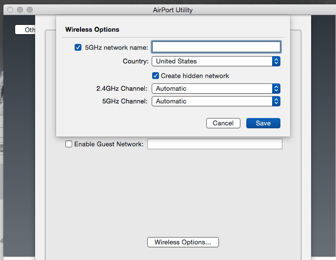

@BulkHedd In AirPort Utility, under Wireless --> Wireless Options, do you have "5 GHz Network Name" checked? If so, uncheck it and check if it works then. Unchecking that box will delete the 5 GHz SSID and let the AirPort negotiate the best band to use with each client (2.4 GHz or 5 GHz).
If I uncheck the 5Ghz doesn't that turn off that band? I prefer that band for my devices. When doing an internet speed test I always get a much higher speed on the 5Ghz band than on the 2.4Ghz band.
No. It will simply make the 5 GHz and 2.4 GHz networks use the same network name.
I don't see a box to check. Just a box to type in the name. Do you mean delete the name?
The tick box right next to 5 GHz network name.
