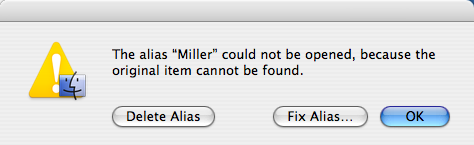

However, something strange is happening now. Usually, my PC isn't even listed in the Network Browser. But sometimes it will appear and then disappear randomly. When it does appear and I try to connecto to it, I get the following error. Does anyone know what might be going on? Some settings I don't have configured right?

Are you networked on a wireless connection? Just wondering if one of them is in the outskirts of wireless reception.
Also, are your settings the same as they were with your Powerbook?
I am on a wireless connection, but I also tried plugging it in and nothing was different. I have full signal according to my airport icon in the menu bar.
I am not sure if my settings were different on my Powerbook or not. That's kind of what I'm trying to figure out: what settings do I need to have to network with another PC properly. Even though in the past, I have always been able to find the network through my Network Browser, I also tried directly connecting like this guide says:
https://forums.macrumors.com/threads/54704/
and that didn't work either. I'm thinking something is not set up right either on my mac or my PC. It should also be noted that while my Powerbook did work flawlessly at one point, the last time I tried to use it, I couldn't find my PC for some reason. Maybe it's something screwy with my PC.
Here's the wierdest part...I can see my Mac and can copy files to it from my PC. But my mac won't connect to the PC. I'd really rather have it so that from my mac I can access my PC.

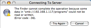

Tried it multiple times already. This is what that guide I linked to earlier says to do. Here is the error I keep getting. I get the same error if I just go to the ip address instead of trying to directly go to a shared folder.

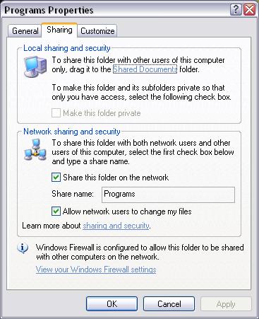

Firewall is configured correctly - see bottom line in the attachment.
I haven't even gotten to a part where they are asking me for user names or passwords. Just error -36's.
