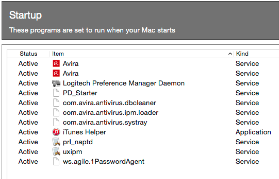

Just out of curiosity, I checked, using “CCleaner” app, what is going on at startup: no “FreeFileSync” being launched (please see the attached report)!
"Ghost in the machine" indeed!
Did I permanently damaged my trusted Mac? Cursing myself… 😱
Please help me if you can.
