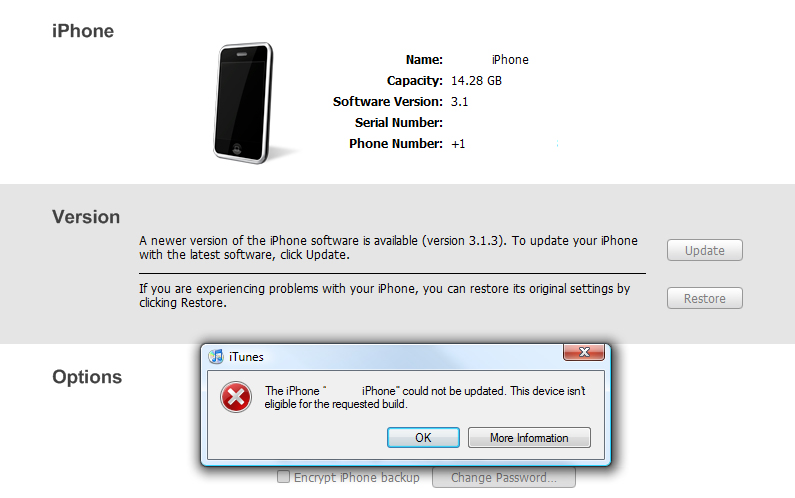

Well I just dropped 440 bucks on a second hand 3Gs, I was all excited b/c it's only at firmware 3.1 and with the 5.11.07 baseband. Things made sense
Anyway bring it home just want to update it to 3.1.2 and just j/b with BlackRain..but no dice... Guess I didn't do my research well.
iTunes is automatically giving me the finger and saying "no! No!" No "Shift Update" for you! No second last firmware for you! only the latest, or GTFO!
So yeah I guess it's similar to trying to downgrade a 3Gs. I am uber frustrated, I guess I can always just jailbreak the 3.1,,,anyone has any suggestions to help me find a way around this or there isn't any? I would appreciate the help, thanks

You are correct. You can only install or restore to the current Apple supported firmware on the 3GS, unless you happened to have your SHSH's on file on Cydia. You might get lucky and find that your devices SHSH files are on the cydia servers, assuming the previous owner jailbroke it for you. For that matter, is it jailbroken now? If so, open up Cydia and see if it says it has a SHSH on file.

Here is what you can do:
1) Jailbreak at 3.1 using Redsn0w.
2) Create using PwnageTool or obtain from a trusted source a custom 3.1.2 firmware and shift-restore to it in recovery mode.
Once your phone is jailbroken at 3.1, you should have no problem shift-restoring to a custom firmware, since the jailbreak process patches the signature check out of the bootloader.

Ok guys thank you so much!! Blackra1n work flawlessly
so now I am on a 3Gs 3.1 jailborken, I also told Cydia to "Make My Life Easier"
and now when I start Cydia on the home page it says "This device has SHSHs on file for iPhone OS: 3.1.3"
