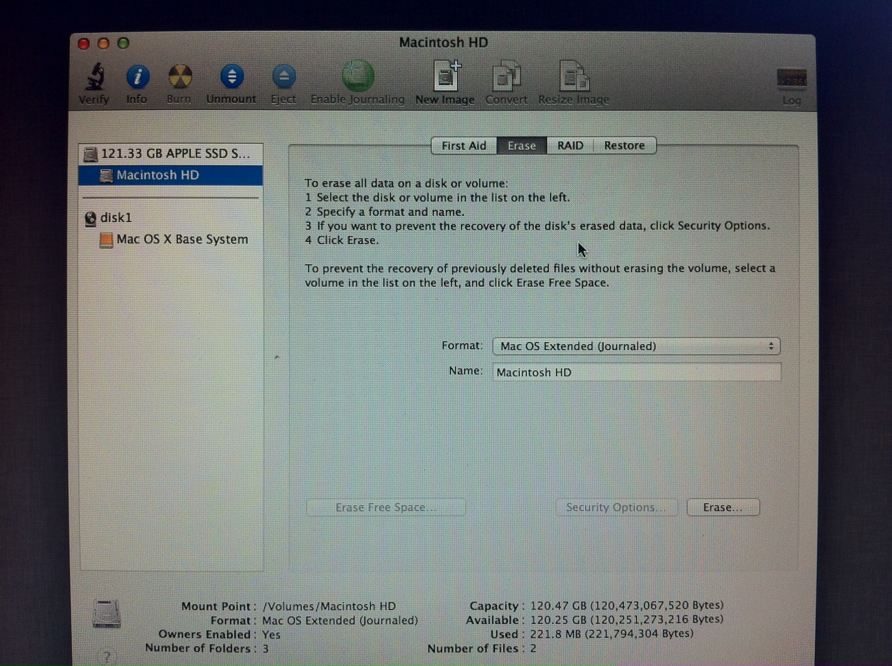

both security options are grayed out...
Perhaps they've disabled the option on the SSDs due to the significant number of writes a zero-ing requires. If what I've read is the case, it would have the potential to significantly reduce the lifespan of the drive, if not render it completely unusable.

There's a discussion here about secure erase and SSD's. There are some interesting links posted regarding the differences between zero-ing hard disks and solid-state drives. The option is likely grayed due to a combination of avoiding wear and the ineffectiveness.
Any definitive answer here? I need to secure erase my MBA in order to return it to Apple by late afternoon today. The Security Options button is greyed out, the only one available is just "Erase". I clicked and reinstalled Lion but I'd rather do a secure erase to ensure that my data is completely unrecoverable. Anyone know for sure?
There really aren't many good options for an SSD. If you have a Linux boot drive, you could try booting into it and doing a secure erase of your OS X partition. One option to try is to simply copy dummy data to fill the drive, but that isn't 100% effective for the same reason that the wipe free space option doesn't work.
Is there a particular reason you are returning the Air (seeing as you just recently purchased it)? If it's to replace a faulty screen or something similar, perhaps you can ask them if they can simply swap out the SSD and put it in your new one. They usually don't do that, but it's worth a shot.
KPOM, thanks for your reply. I'm returning because I'm thinking I'd rather go for the 13". I bought the 11" to try out. No Linux drive here either.
So there is no real option? And even if there are some options, none of them really work?
you need to click on 121.33 Gb Apple SSD to be able to pick erase free space.
Otherwise you can only select to erase, which erases your entire disk.
I've clicked on all options on the left and none of them enable the "Erase Free Space" or "Security Options" buttons.
I zeroed out my 11" yesterday (through Disk Utility) and it worked fine. I did have to boot into recovery mode though, command-R on bootup.
It didn't show it at first but after I mounted my (FileVault-protected) partition I was able to select Secure Erase from the Erase tab. So it was available but only under certain conditions.
One thing to note was that after a reboot it wouldn't get back into recovery mode, it had to do the whole internet boot thing (which somehow wasn't compatible with my router, so I had to find another router). It then downloaded a new recovery image and I could then reinstall Lion over the Internet. Took about 2 hours over 25mbit.
So it must have zeroed out the recovery partition as well, strange because I was expecting for it to leave that alone automatically.
Probably the best option is to turn on FileVault2 and encrypt the contents of the drive. That way, if someone does access your data, it's encrypted anyway.
So it only shows if you FileVault-protect your Macintosh HD partition? Otherwise, it won't show? If so, then only an encrypted partition will be allowed to secure erase and it won't let you for a non-encrypted partition?
I see, but I guess it's too late for that now right?
This will be because "securely erasing" an encrypted storage medium (be it flash, SSD, hard drive, CD etc.) can be achieved by trashing the encryption keys. Once this is done the storage device is still full of your data but it is useless because it is just unintelligible noise to all intents and purposes. This isn't secure wiping, it just renders the data useless. In the case of a hard drive, after trashing the keys the hard drive will then go on a perform a secure erase as normal, on an SSD this will not happen AFAIK. The same technique is used for iPhone/iPod Touch/iPad for wiping the device (remotely or locally). It just trashes the encryption key once again.
