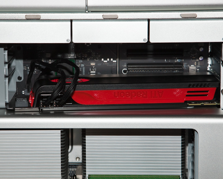

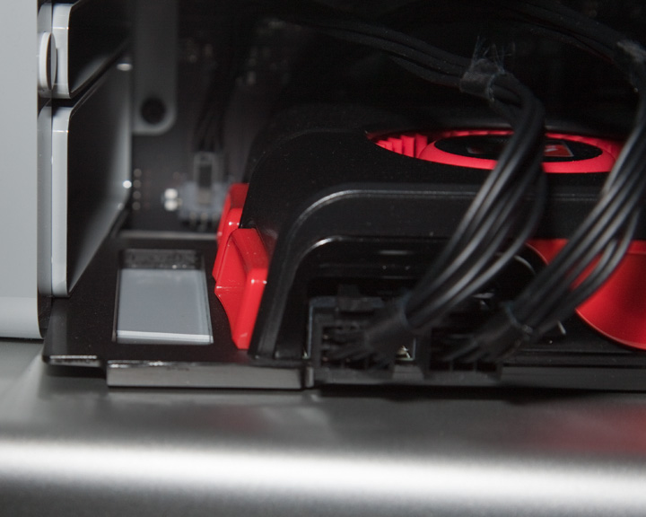

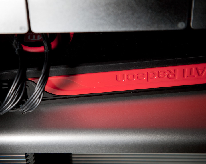

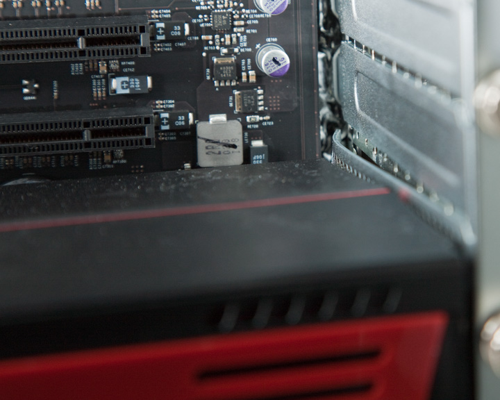

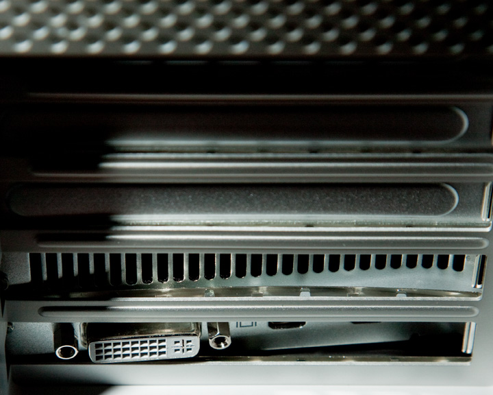

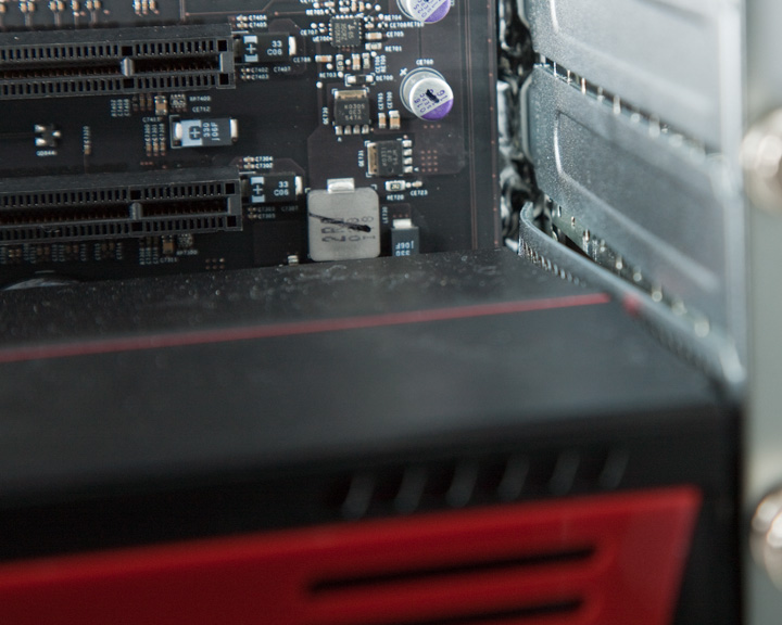

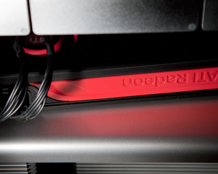

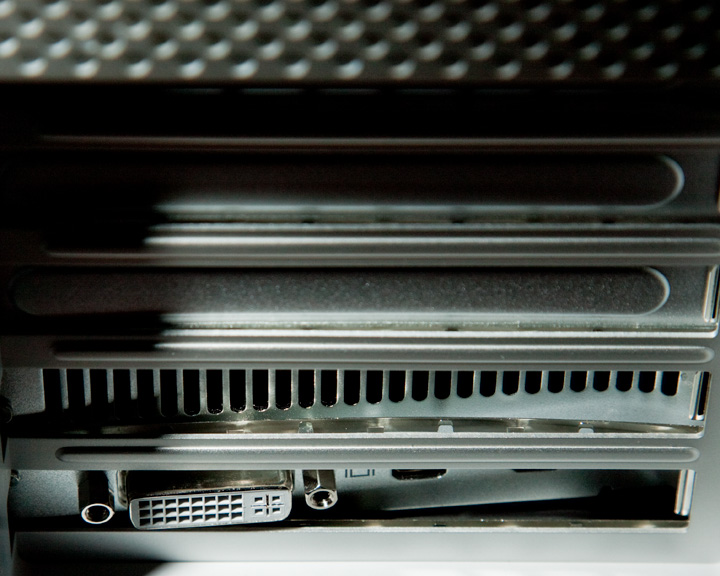

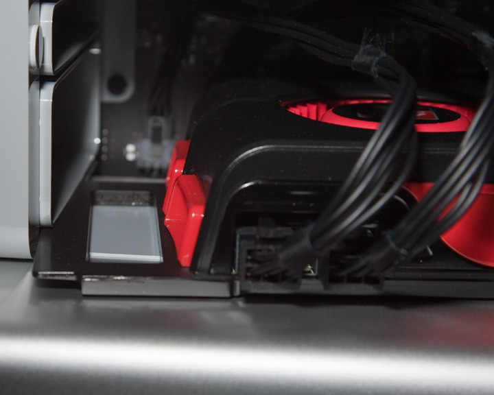

Here are some pics of my DOA $5K Mac Pro
Pic 1 - you can see the back of the video card caved in on the right side.
Pic 2 - the Radeon 5870 is stuck in at an angle
Pic 3 - inside view of the video card mounting area bent inward
Pic 4 - is the card mounted upside down?
Pic 5 - large view, you can see how it looks like the card was pulled out at an angle
Any comments helpful.

the card is mounted the correct way up, it'll only go in one way 😉
it's hardly smashed in lol, have you tried removing the card and reseating it?, if that dont work, send it back to apple for a replacement 😉

From the looks of the pics, the metal bar that locks the GPUs in might have been "bumped open" with a hard enough bump (or it was never locked in place which is more likely). Without this lock the shear weight of the card could have easily been unseated. Then, from being unseated during transit it kept on pulling on the "port" sheild and bent that a bit (pic3). I'd just reseat it, I doubt it's damaged . . . btu I'd be pretty pissed too 😀

He shouldn't even bother with that, the vent grill is clearly bent - like as if someone tried to pull it out at an incorrect angle.
