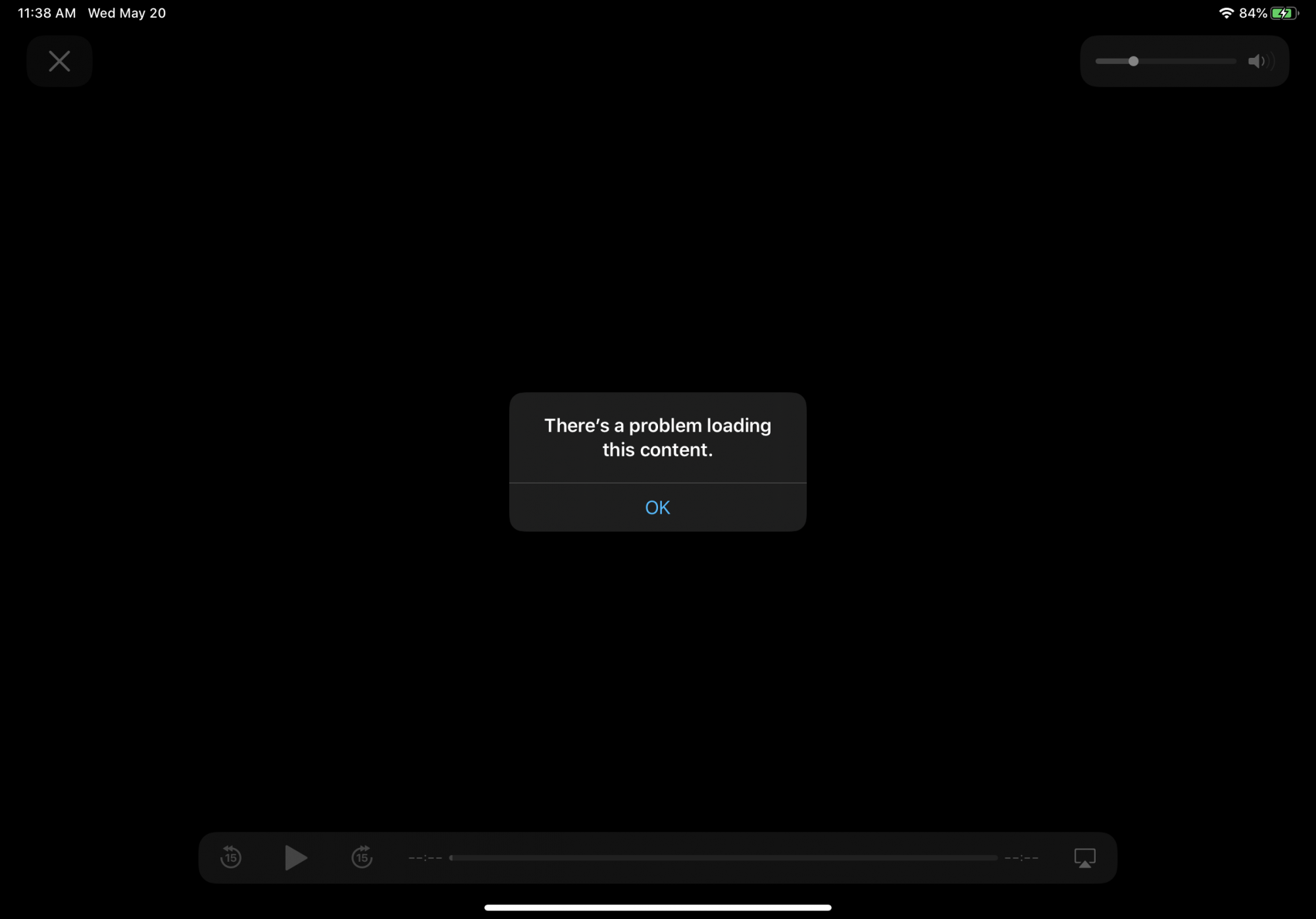

Apple content seems to play fine. The problem is with some video libraries-files loaded on the iPad via iTunes. When they are played in the iOS TV app it throws the error message. This started immediately after updating to iOS 13.4. It’s a bug, no one is sure the nature (video codec, audio codec, resolution, etc...). It also appears to affect other video apps, which leads me to believe its in iOS.

I copied it into Files and got a failure when trying to play it. I copied it into nPlayer and it plays fine there.
Edit: From within Files, I shared and opened with Infuse & VLC and those apps could also play it. Tried to play it with FileBrowser for Business and FileExplorer Pro and it would not play; both of these play other mp4 files without a problem.

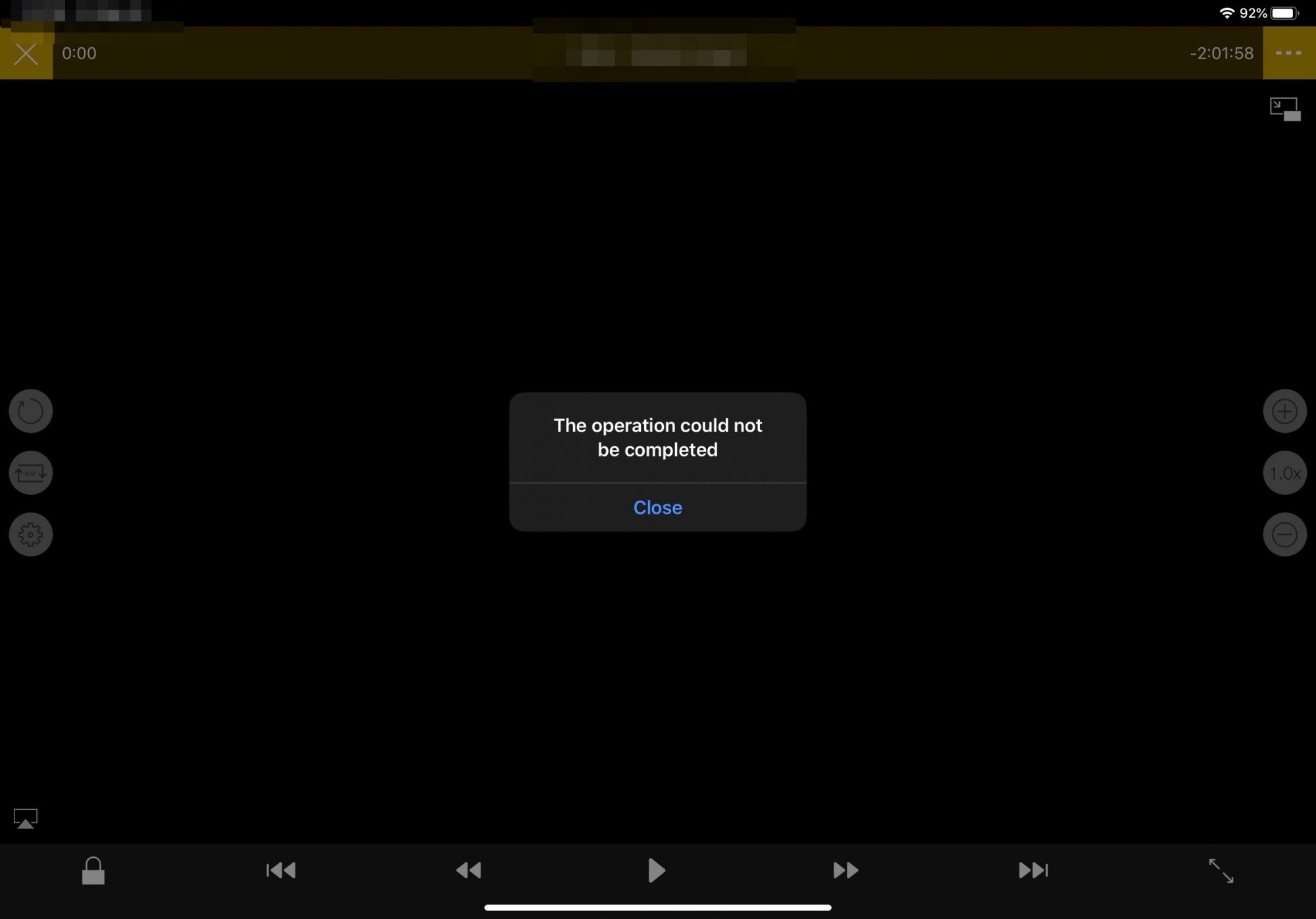

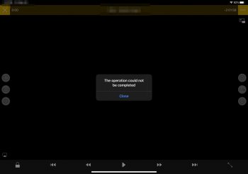

Here’s latest version of nplayer playing same file right after iOS TV app which threw the “there’s a problem loading this content” error. Same problem, different error message. Played fine on both apps before 13.4.
I can’t explain why the file isn’t working, all I know is it started immediately after updating to iOS 13.4 and persisted with every subsequent release, including 13.5.
