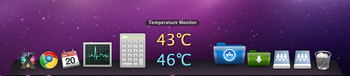

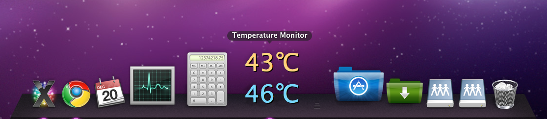

Hey guys, well had my MBA alittle over a month now. I have switched from using Istat nano to using "temperature monitor". I find that i get more accurate results from this program because from what i understand, Istat nano only reads the CPU diode, not tapping into the x86 readings of the chip itself. The CPU diode is a analog sensor that typically is not accurate to the true CPU temp.
"temperate monitor", is free, and comes with a driver that actually interfaces with the intel temps of each core, thus you get accurate readings from the cores, this is what matters to me. It also uses ALMOST no system resources itself. It also has a option of dynamically displaying the core temps in the dock which is cool. So long story short, I think this program is better!
I have permanently disabled both dashboard and expose (never use them and they are resource hogs) and am using the new beta of chrome with beta 2 of flash.
I am now at idle at 29c - 36c depending on ambient room temp on both cores and run at about 46c under normal usage (streaming mp3, chrome multiple tabs open, email open, etc) with my mac connected to my a new 27'' ACD. Pretty Happy!
