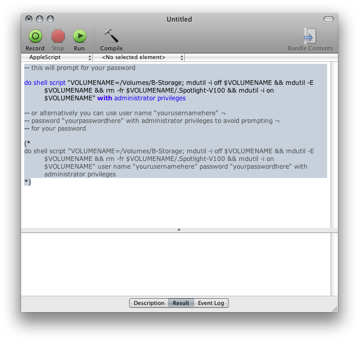

Try this :
Code:
-- this will prompt for your password
do shell script "VOLUMENAME=/Volumes/B-Storage; mdutil -i off $VOLUMENAME && mdutil -E $VOLUMENAME && rm -fr $VOLUMENAME/.Spotlight-V100 && mdutil -i on $VOLUMENAME" with administrator privileges
-- or alternatively you can use user name "yourusernamehere" ¬
-- password "yourpasswordhere" with administrator privileges to avoid prompting ¬
-- for your password
do shell script "VOLUMENAME=/Volumes/B-Storage; mdutil -i off $VOLUMENAME && mdutil -E $VOLUMENAME && rm -fr $VOLUMENAME/.Spotlight-V100 && mdutil -i on $VOLUMENAME" user name "yourusernamehere" password "yourpasswordhere" with administrator privileges

OK unfortunately this comes up with the following error:
error "/bin/sh: -c: line 1: syntax error near unexpected token `&&'
/bin/sh: -c: line 1: `&& mdutil -E $VOLUMENAME && rm -fr $VOLUMENAME/.Spotlight-V100 && ¬'" number 2

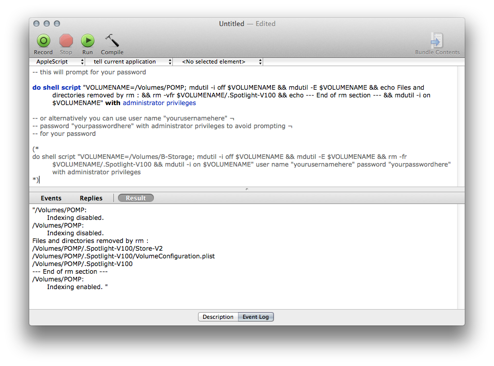

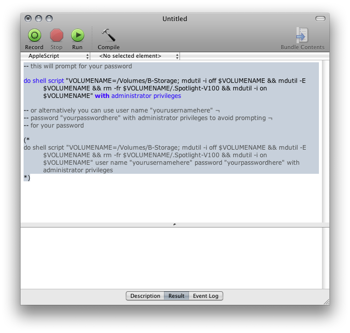

ok well after a couple of days of normal behavious, the spotlight index went wrong again.
I ran the script... and nothing seemed to happen. In the description log box below it says:
"/Volumes/B-Storage:
Indexing disabled.
/Volumes/B-Storage:
Indexing enabled. "
Which is fine, but the spotlight continues to "estimate indexing". Its as if the applescript isnt doing the part whenre it is supposed to delete the spotlight index files.
Doing the stages manually works, but auto-scripting isnt, for some reason
Works for me. Do you mean you don't see any output of the rm command?
Try this :
Code:
do shell script "VOLUMENAME=/Volumes/B-Storage; mdutil -i off $VOLUMENAME && mdutil -E $VOLUMENAME && echo Files and directories removed by rm : && rm -vfr $VOLUMENAME/.Spotlight-V100 && echo --- End of rm section --- && mdutil -i on $VOLUMENAME" with administrator privileges

Ahha well, that did seem to work properly, would there be any chance you could make that echo change for the one that doesnt require me to enter my password each time?
Really grateful for your help, hopefully I can get this down so I dont have to keep messing around with it... such a stupid and needless flaw in the OS
If I understand your question correctly you don't want to enter your password each time the script runs right? The answer to that is in the script. Replace this :
Code:
with this :
Code:
and change yourusernamehere and yourpasswordhere with the appropriate account values. Values must be entered between the quotes!
Example with pseudo values :
Code:
user name "bob" password "password" with administrator privileges
