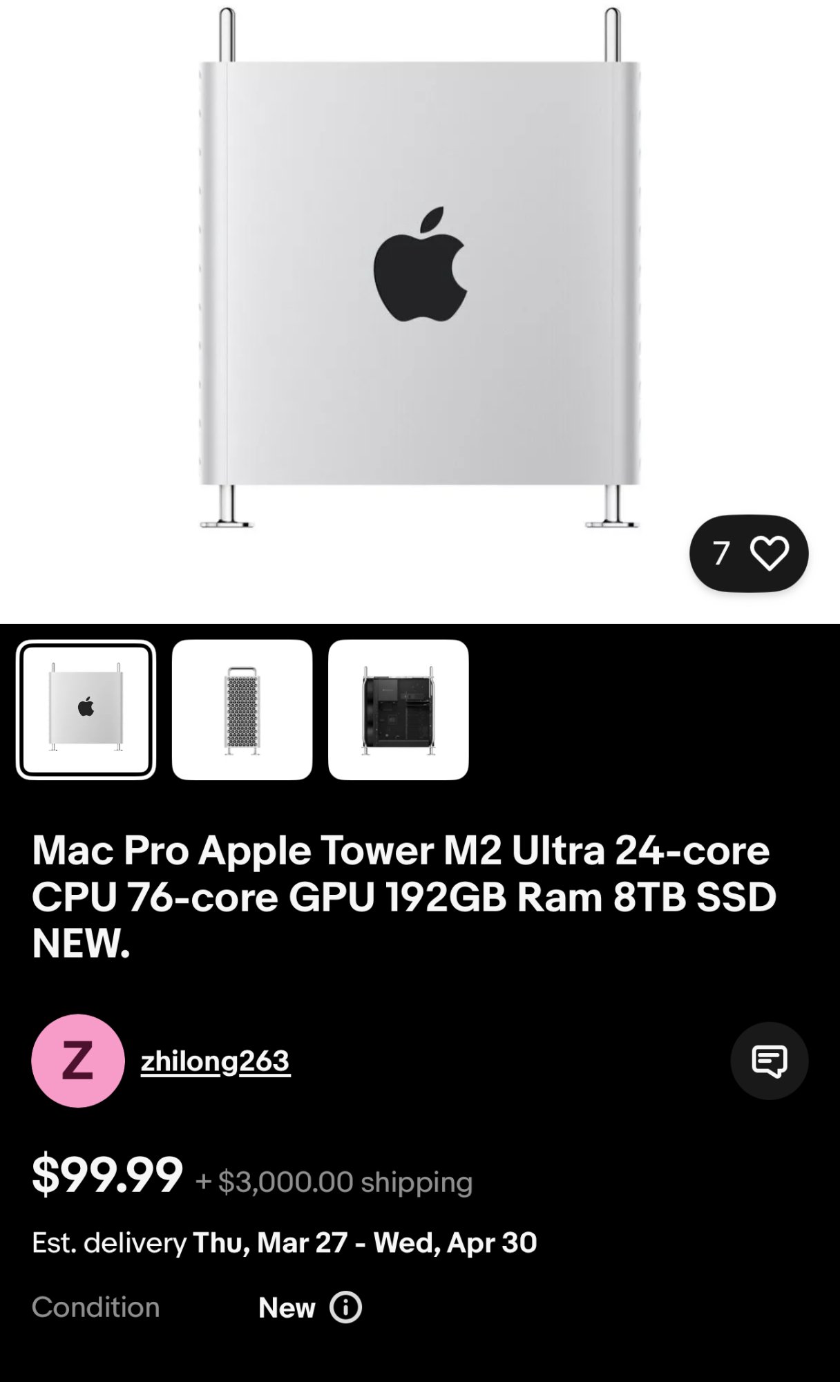

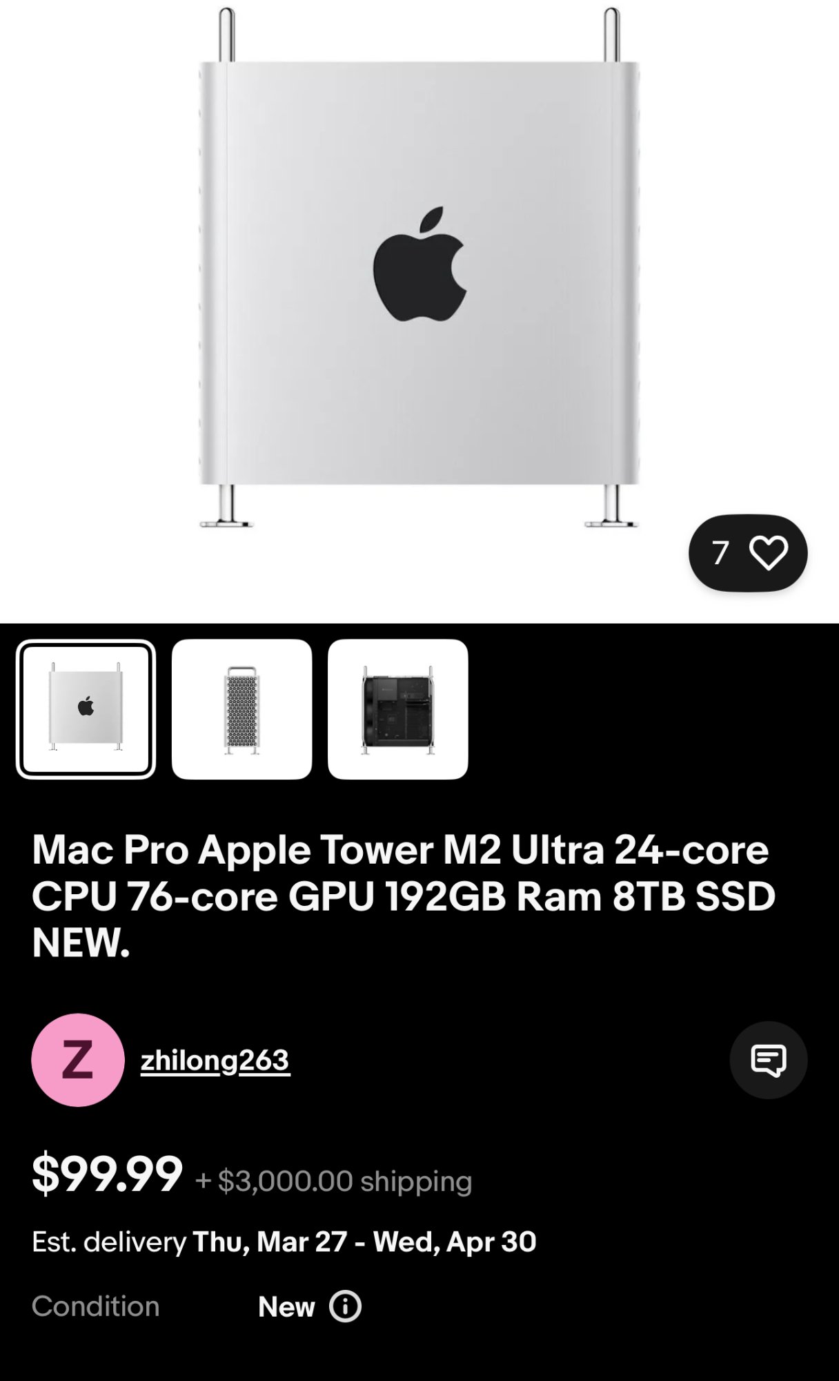

It’s interesting that people are collecting these things now…
I just saw this lovely 2019 Mac Pro on eBay. Something just doesn’t seem right about the $99 price tag though. I can’t quite put my finger on it 😂

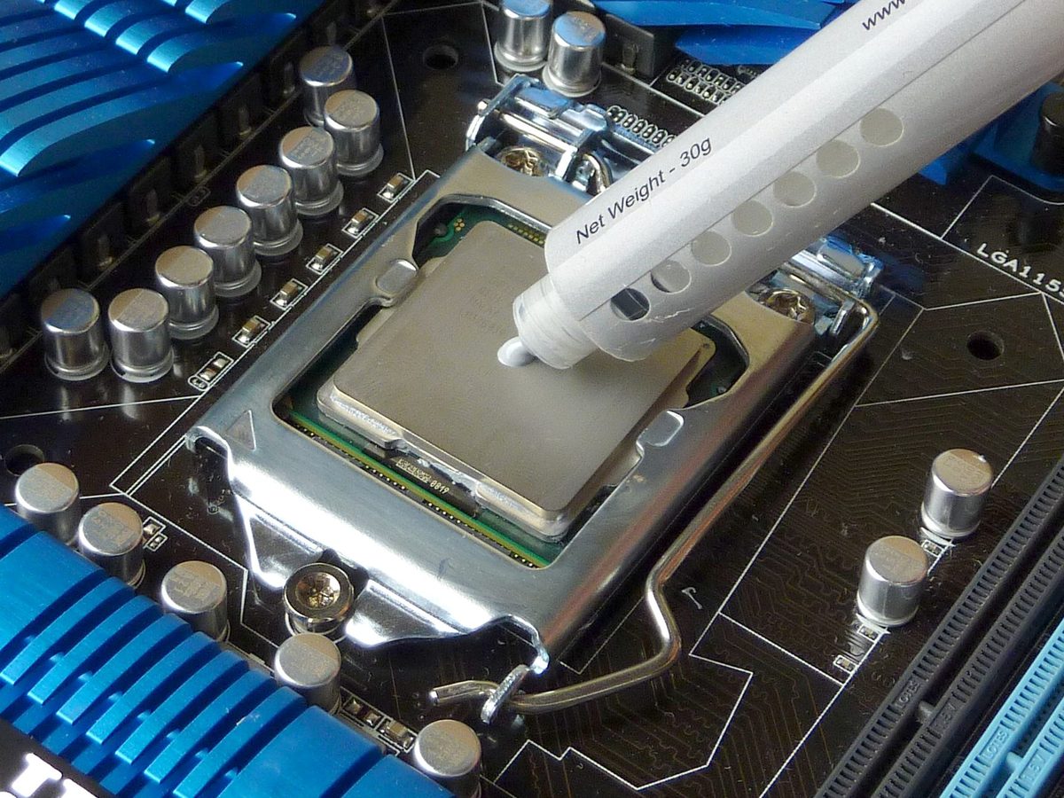

I can only recommend that you completely disassemble and clean the system at the beginning and from time to time, depending on the environment. An electric blower that can be adjusted using air pressure helps a lot. But I would also recommend that you expose everything from the CPU and GPUs and remove and clean any old thermal paste. Then apply high-quality new ones according to the scheme:

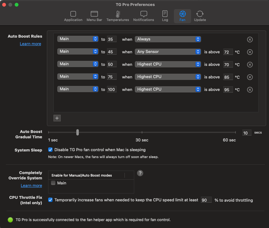

I can also recommend raising the fan curve a little with TG Pro, contrary to the automatic control. This is hardly noticeable, but it helps enormously to reduce the peak temperatures of the PCIe switch, for example. As is well known, this is the worst cooled element. Overall, however, the overall temperature of all components can be reduced well. It is also advisable to set up basic conditions in TG Pro that make it clear when which fan curve should be used. I have attached a screenshot of mine for you.
