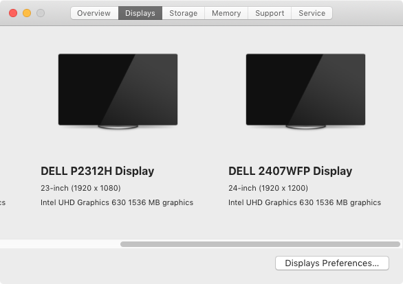

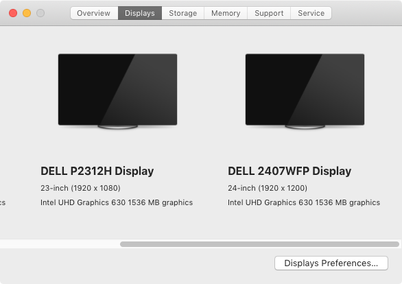

i picked up a DELL P2312H monitor for $3 at the local thrift yesterday. It’s working fine at 1080p when attached to my 2014 Mini “headless” server via an HDMI<->DVI cable. 🙂
So I gave it a try on my 2018 Mini using the same cable ...
1 - the 2018 Mini recognizes the P2312H as 1920x1080 @ 60Hz
2 - it even gives me the option for a few other scaled resolutions
but
3 - the DELL monitor is not happy and displays “The current input timing is not supported by the monitor display. Please change your timing to 1920x1080@60Hz or any other monitor listed timing as per the monitor specifications” regardless of the scaled resolutions selected in System Prefs>Displays.
This is the same problem I had with my Dell 2407WFP monitor when it was attached to the 2018 Mini using the same HDMI<->DVI cable. So it may be that the HDMI<->DVI cable, that works fine with 2 different Dell monitors on the 2014 Mini, is somehow incompatable with the 2018 Mini's HDMI port. OR it may be the problem is the 2018 Mini’s HDMI port.

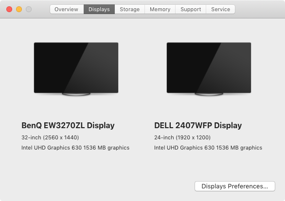

Just to bring you up to speed I disconnected the DVI cable and I've now managed to start up using both the HDMI>HDMI and the USB-C>HDMI albeit with black screen issues as others have mentioned.
I took my Mini to a friends house who has a Dell Alienware AW3418DW monitor. Again tried the same leads and eventually managed to log in with the HDMI>HDMI and the picture looked a whole lot better.😃
Try as I may I cannot get my old (2006) BenQ to change resolution to 1920x1200🤔😞
