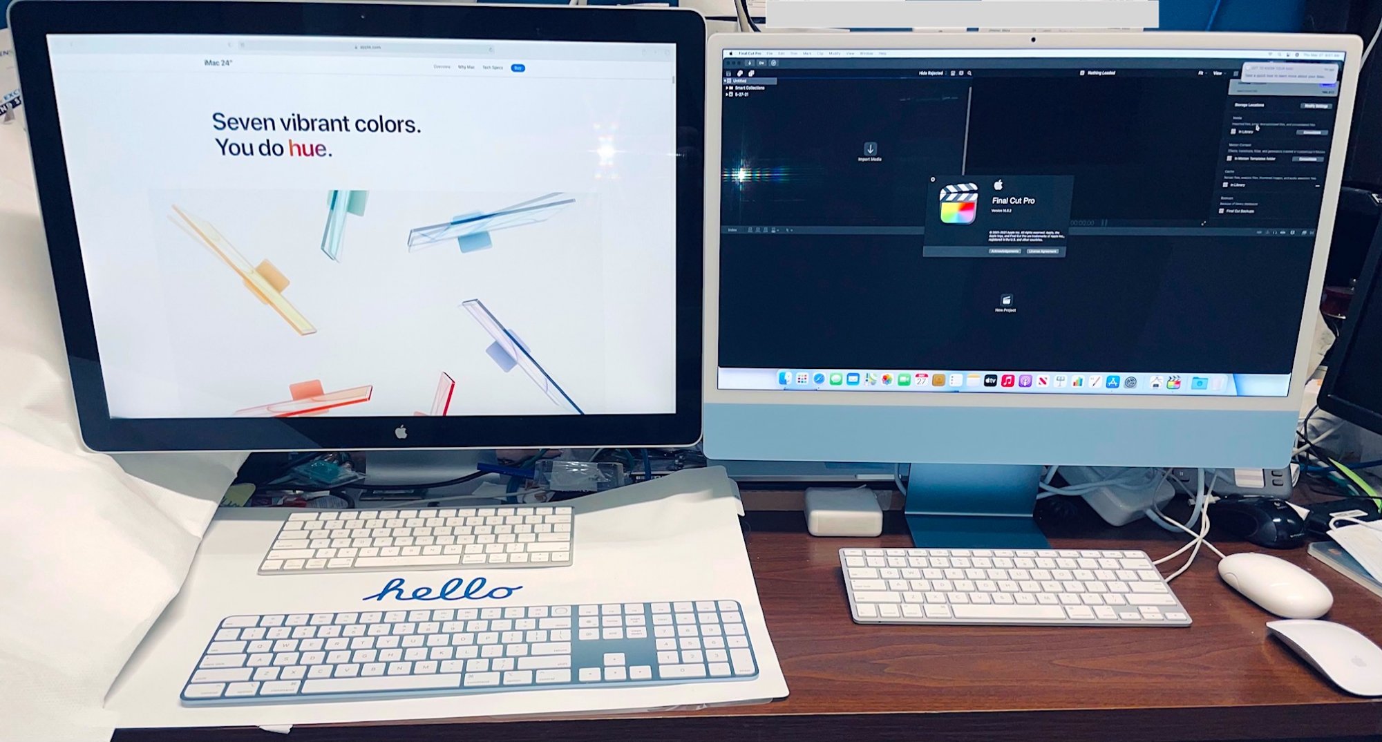

Well I have the "cheaper" M1 iMac (base with 2 ports) and it works perfectly.
I used a Time Machine backup from my 2015 MBP (Catalina) and it transferred perfectly using Migration Assistant into the M1 iMac.
Using a genuine Apple TB3-TB2 adapter (LaCie TB external SSD), USB-C to Mini Display port adapter (24" Cinema display), and a BlackBox USBC2000 dongle for my 3 USB-A where my Apple SuperDrive, SoundBlaster Play3 DAC, and my wired mouse.

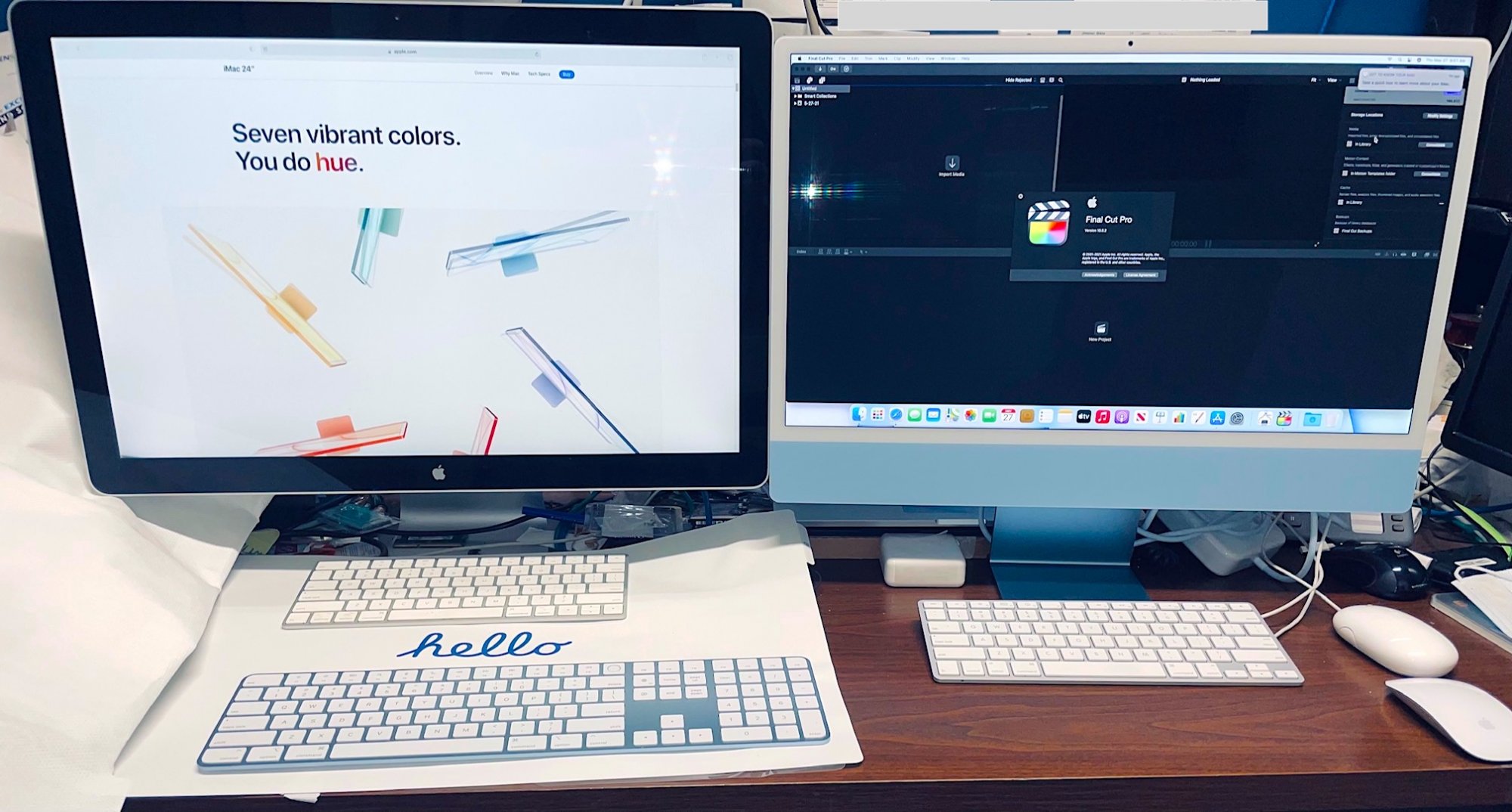

I cannot ignore the real estate wastage that is visible here, despite the new iMac being Retina and multi-K as against 1920x1200.
