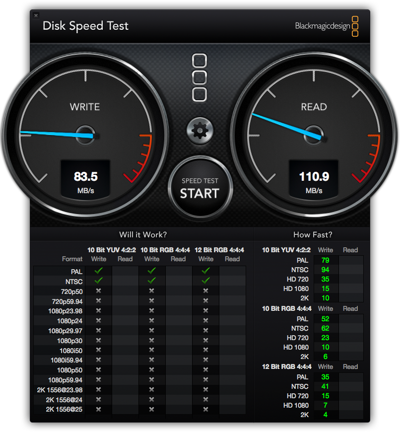

Hello fellow iMac users.
On 2/14, i purchased a 27" iMac, i5, 3.2Ghz, with the 1 TB fusion drive.
by 2/27, I was calling Apple because of constant Kenerl Panics.
After 2 weeks of troubleshooting, I couldn't find an issue. Apple suggested a software issue, and re=installed the OS, which I did, and then was still noticing sluggishness. I did a BlackMagicDesign - Disk Speed Test from the Apple Store. The test was reading 30-150MBps. This is absurdly slow. USB 3, and a 7200RMP disk can transfer data faster than this. Apple agreed to do a hardware exchange.
Now, on my now sold 2013 iMac with a 3TB fusion Drive, I was seeing Read/Write speeds above 500MBps., with this same test.
On my 2014 MBP, i'm seeing 1200Mpbs Read/Write speeds.
On my Brand new, out of the box(2nd version) iMac 27", i'm seeing the same poor performance of the Fusion drive.
Local Mac Tech Shop tells me that it is the 16GB of crucial memory, the software controlling the fusion drive (which they believe i know how to access and manipulate), or some other fault of mine, using a brand new out of the box iMac.
Is there a bad run of fusion drives? am I doing the test incorrectly? help me find out what's missing please.

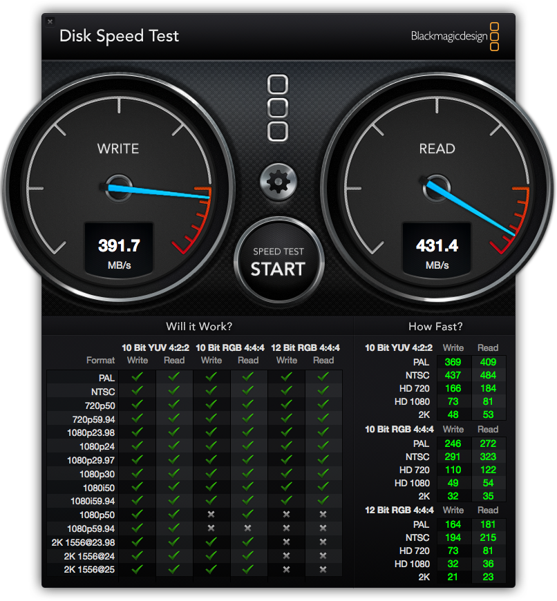

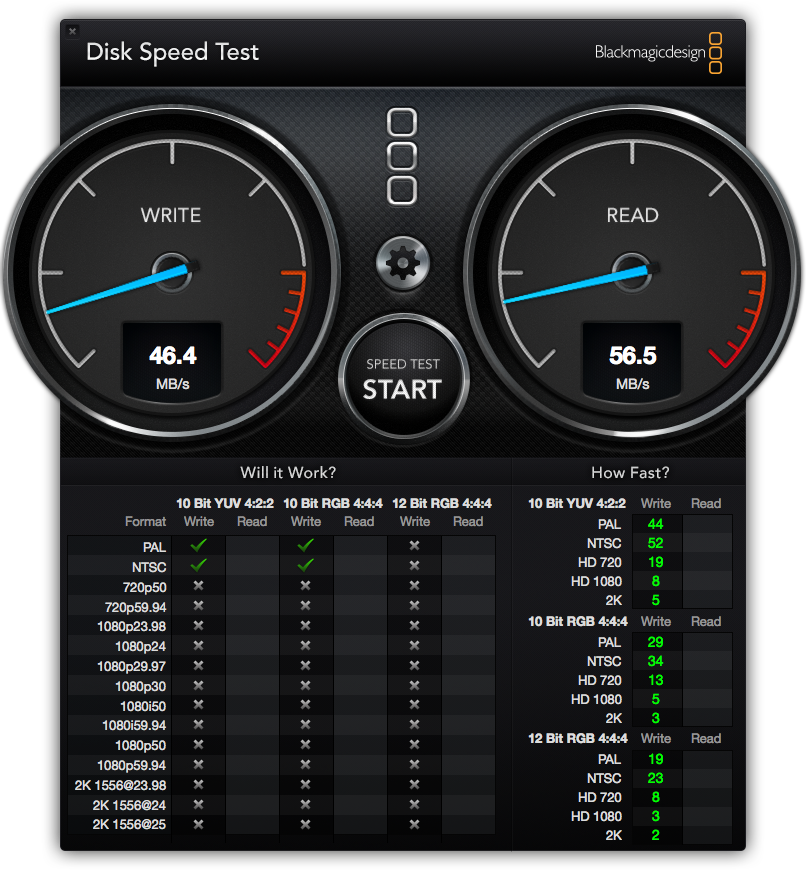

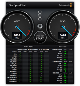

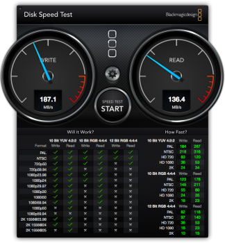

I posted 3 pics: the iMac Fusion Drive, a USB 3 5400RMP drive, USB3 Samsung SSD.
advice please.
You probably want to know how this is setup and what special stuff i'm using. Here is what i've done:
1.) setup up user account. (did not restore from backup)
2.) Copied 2 linux virtual machines to the drive, 10GB each
3.) installed VMWare Fusion 8 pro.
4.) Installed Dropbox. (note that dropbox was paused during the test results I posted).
5.) I of course installed Blackmagicdesign Disk Speed test from app Store.
thanks in advance.
1TB Fusion Drive is not what it used to be one year ago. In the past it was 128GB SSD + 1TB HDD, but now they switched to just 24GB SSD and 1TB HDD. Performance is much worse and 24GB drive fills up really quick. Only 2TB and 3TB Fusion Drives contain 128GB SSD nowadays.
QUICK EDIT: wrong video, a minute. Finding speed test of 1TB Fusion Drive from Late 2015 is really frustrating. Nothing, just nothing.
Unless, you know, 24GB are filled pretty quick. Might be that the video was run out of the box on brand new machine, while you have already filled up 24GB SSD. HDD might be as slow as first picture you have attached.
Those speeds do look too slow, even for a spinning hard drive.
I'm able to see write speeds at the 187 Mb/s level at the slowest. I had to run this multiple times to see these slow speeds. They were in the 250 range for the other tests.
I'm seeing this as well, and I'm assuming its on the SSD now and thus the faster speeds
Merode - Thanks for the info.... yeah, i scoured google, nothing. I did notice as well about the 24GB SSD Drive size.
Mayflynn - thanks for the tests. I can sometimes get my test to get those results, but often times it'll drop to 20GB, especially if I use it in the to say, open a document. or Launch Safari.
I'm returning it, and getting one with an SSD, or maybe it's time to make the switch back to a PC....sigh. :-(

My buddy and I have a theory.....I use Virtual Machines (typically 3 or 4 open at a time). These machines are 10GB+ files. This would easily overwhelm the SSD, and most likely cause the SSD to constantly write, and re-write data. Since SSD's work differently with respect to writing over old data than HDDs, I think the garbage collection process that the SSD uses might be getting in the way of reading/writing files, especially to such a tiny drive. A constant write, delete, garbage collection, rewrite, etc....could create a big performance hit, especially with a minuscule drive. (I wonder how much $$ apple saved on this)
Regardless, the performance is quite terrible. I'm constantly seeing a rainbow spinning wheel... i'm looking forward to the SSD arrival.
You may have found the cause.
The use case for a Fusion Drive is basically: the regular usage of the storage is such, that the system can automatically determine what needs to be on the SSD and what can be stored strictly on the slower harddrive.
Perhaps your use case doesn't fit the Fusion Drive at all, and it totally overwhelms Core Storage like you suspected.
In any case, relax and just return it. Many people here and elsewhere have called the 5K iMac "the best computer they've ever owned". Get the 512 gig SSD and be happy again :)

If you can't replace i would suggest to connect an SSD like the samsung 850 and use it as boot drive.
NB: I'm not saying there isn't something wrong with your Mac, but...
Bear in mind that these speed tests tend to be biassed towards sustained read/write speed on large files (you can tell at a glance that the BlackMagic's speed test's emphasis is 'can I read/write video at resolution X'. That is never going to be the strong point of a fusion drive, and the new "1TB" fusion drive with 24GB is even worse.
If you're not editing 4k video, a large part of the SSD advantage is not the sustained read/write speed but the seek times when accessing lots of small files (which, even on a cheap, slower SSD is orders of magnitude faster than on a spinner).
Essentially, all the 24GB SSD is going to do is cache the OS, regularly used application and maybe any swap file. That should make the machine boot quickly and be nice and zippy for day-to-day browsing, email and WP but its not going to help much with heavy duty data munging (your theory about the VMs not playing nice with fusion sounds plausible).
