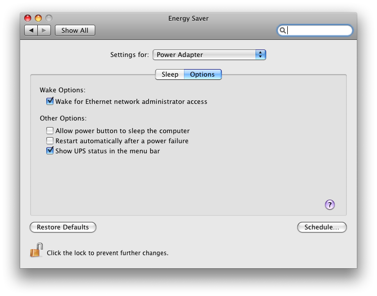

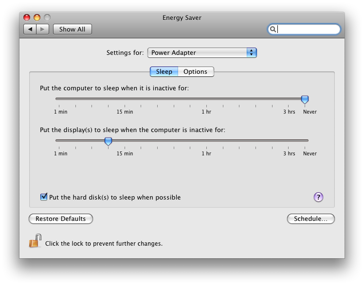

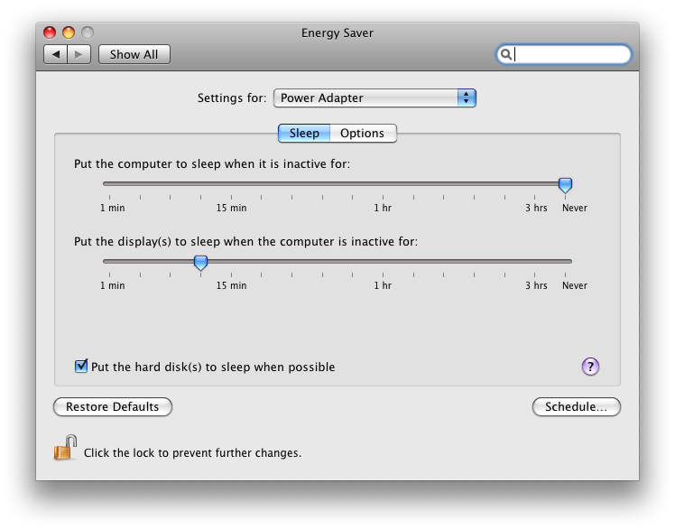

the HD is most likely spinning down, and when you want to read it it take about 9seconds to spin back up. there is a setting in System prefs>energy saver to turn this off.

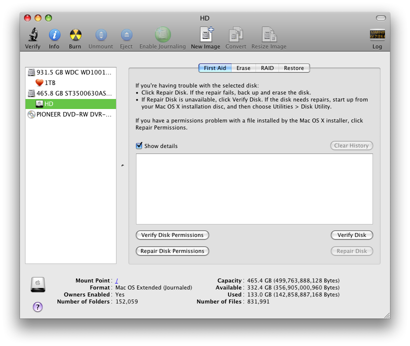

thanks but where??? turn off which option? 😕

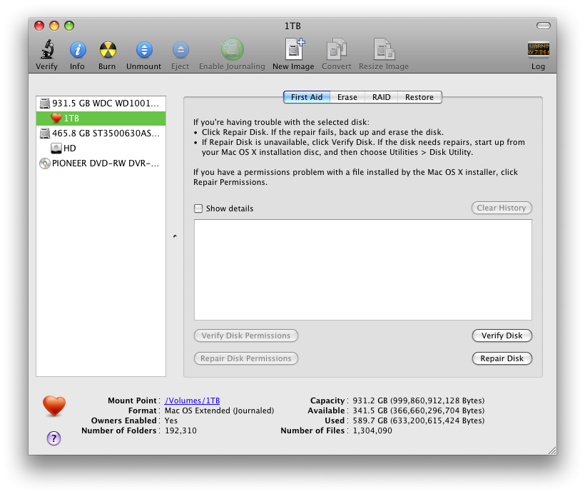

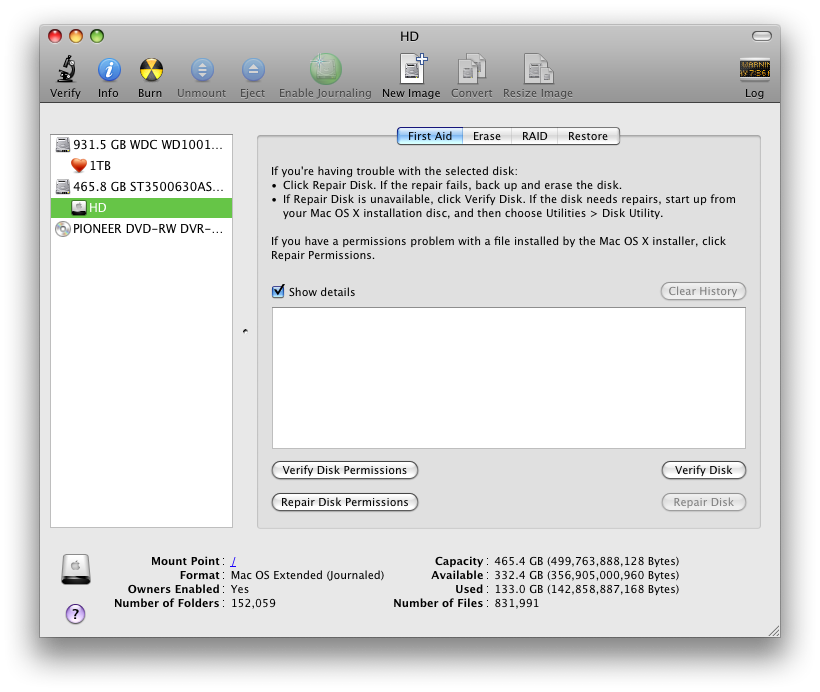

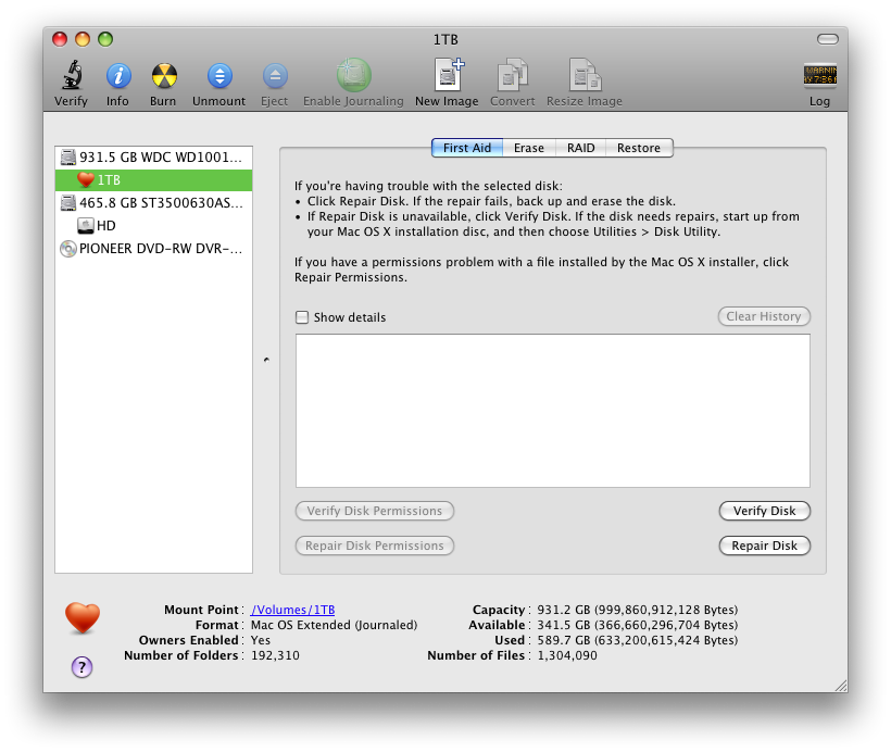

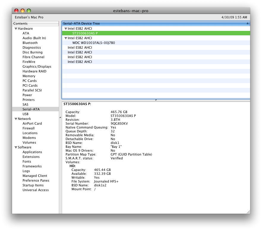

thanks Tesselator, first thing, the issues is on both hds!, when I buy the new WD 1tb, and insert this thing happend.
[*]What format did you use?
Mac OS Extended Journaled on both hds...

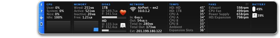

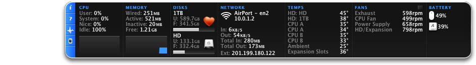

[*]How hot is the drive during this behavior?
please see the istat statics screenshot
[*]How old is the drive that's giving you the trouble?
I repeat both see the issues, I buy the 1tb since 5 days ago from OWC

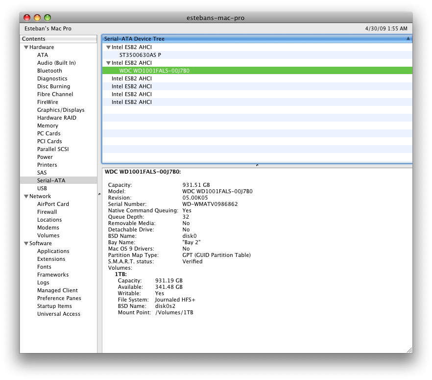

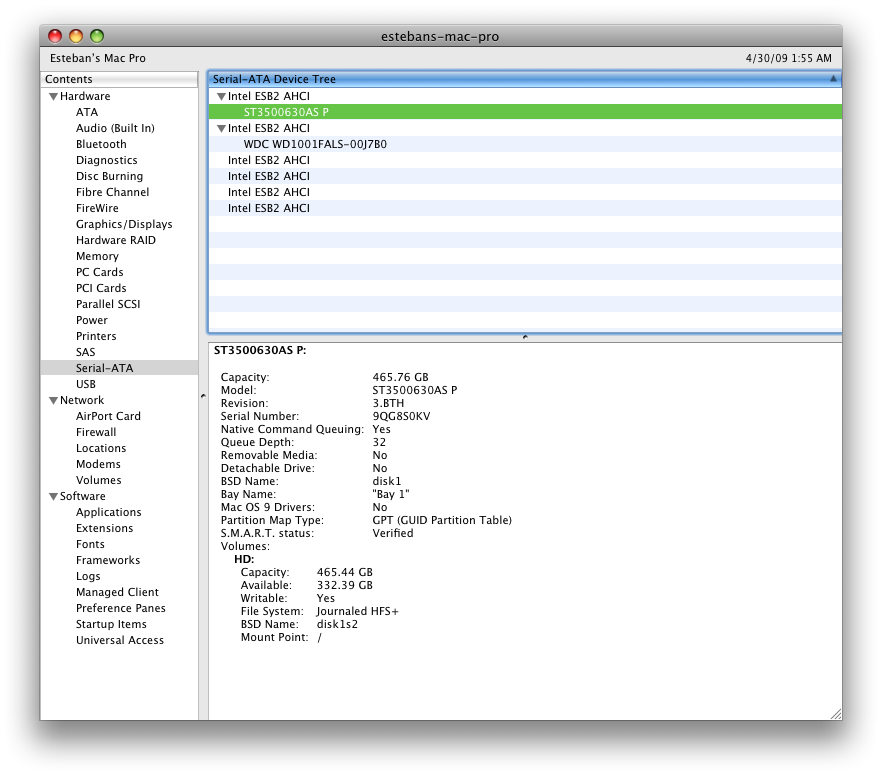

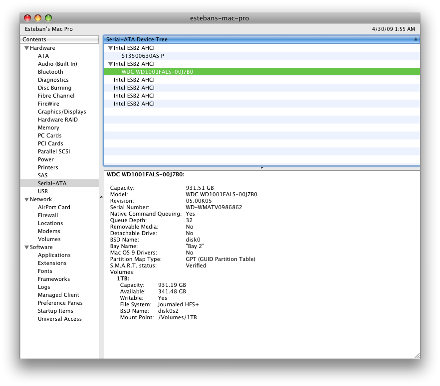

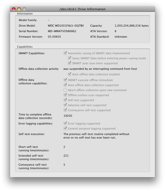

[*]Does the drive have S.M.A.R.T. and if so did you check it?
smart status on both say, Verified see the attach.
please see my steps of this issue:
I have a macpro 08, with a 500gb hd (everything is ok)
I buy a WD "black" HD (WDGWD1001FALS) 1tb
I insert the 1tb
I erase and install the system (leopard)
I get a delay of 9 seconds!!!! 😱
I eject the 1tb
I erase and install the system (leopard) AGAIN, BUT without the 1tb inside
Everything ok...
I insert the 1tb... I GET THE DELAY AGAIN (the video) now for 2 or 3 seconds!
help! thanks 😉

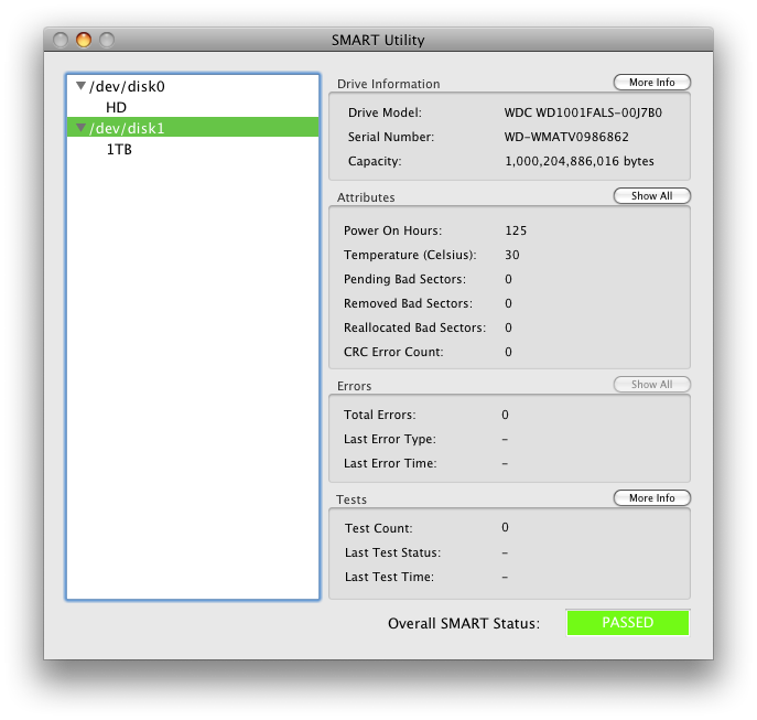

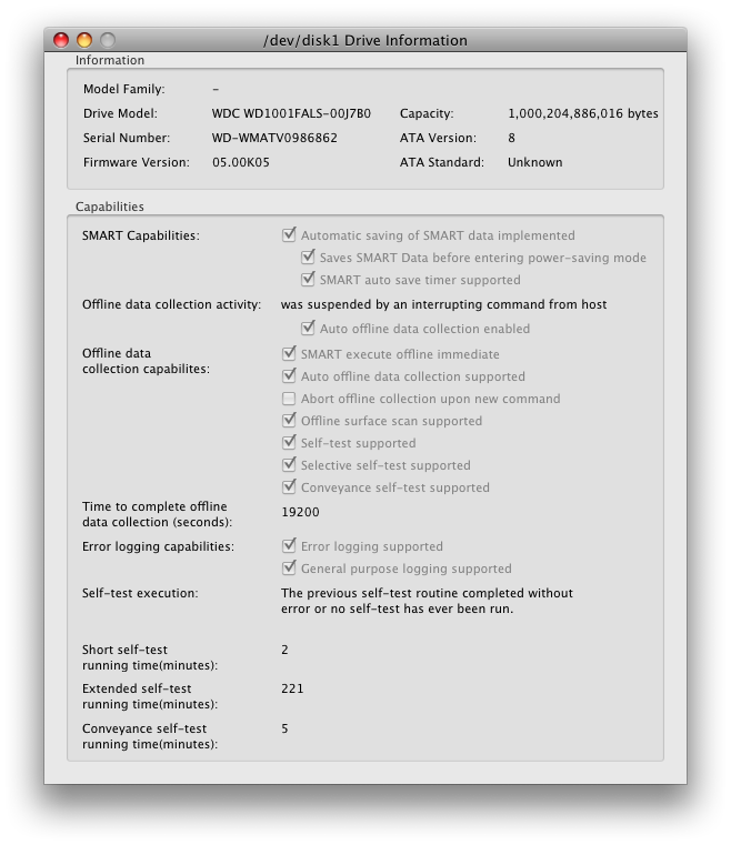

Yeah, I did but I'm not smart enough to deduce anything from that. 😀
Also to check your SMART use a utility like http://www.volitans-software.com/products.php or do a search for a different one. As you describe things it's probably not errors but it could be.

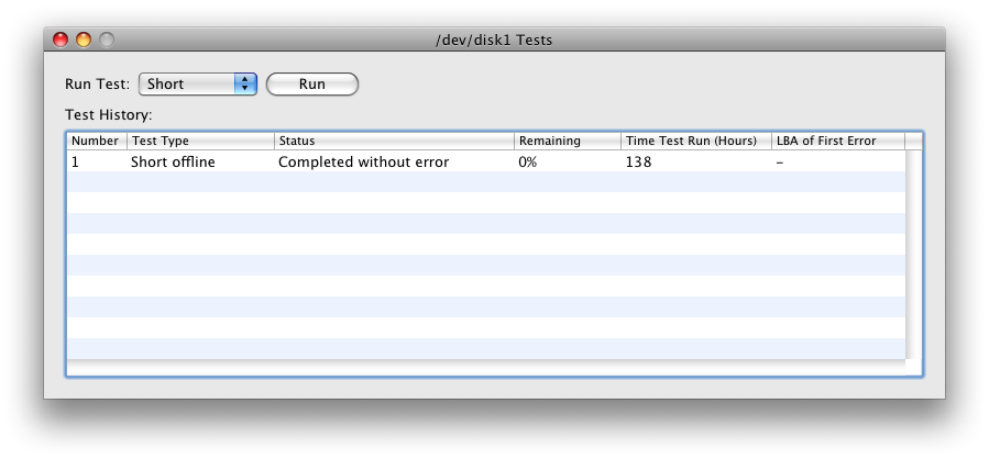

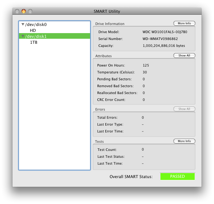

both say passed, 🙁 I dont know why of this little delay... with the new hd... I buy WD "black" because I think that is a good drive... but well I dont know if I choose a bad hd...
Click on the More Info and Show All buttons. Also maybe run the "Short Check" contained within that utility. The "PASSED" just means that the error rates and stuff are within the limits. A new drive should have like, zero instances of any of the error fields. So I was thinking it might point to something.
If this were SCSI where one unit can actually affect another I'd know what to tell you - maybe. But I've never heard of this on two individual SATA busses. I'm stumped.
thanks, heres the screenshots! any solution?
