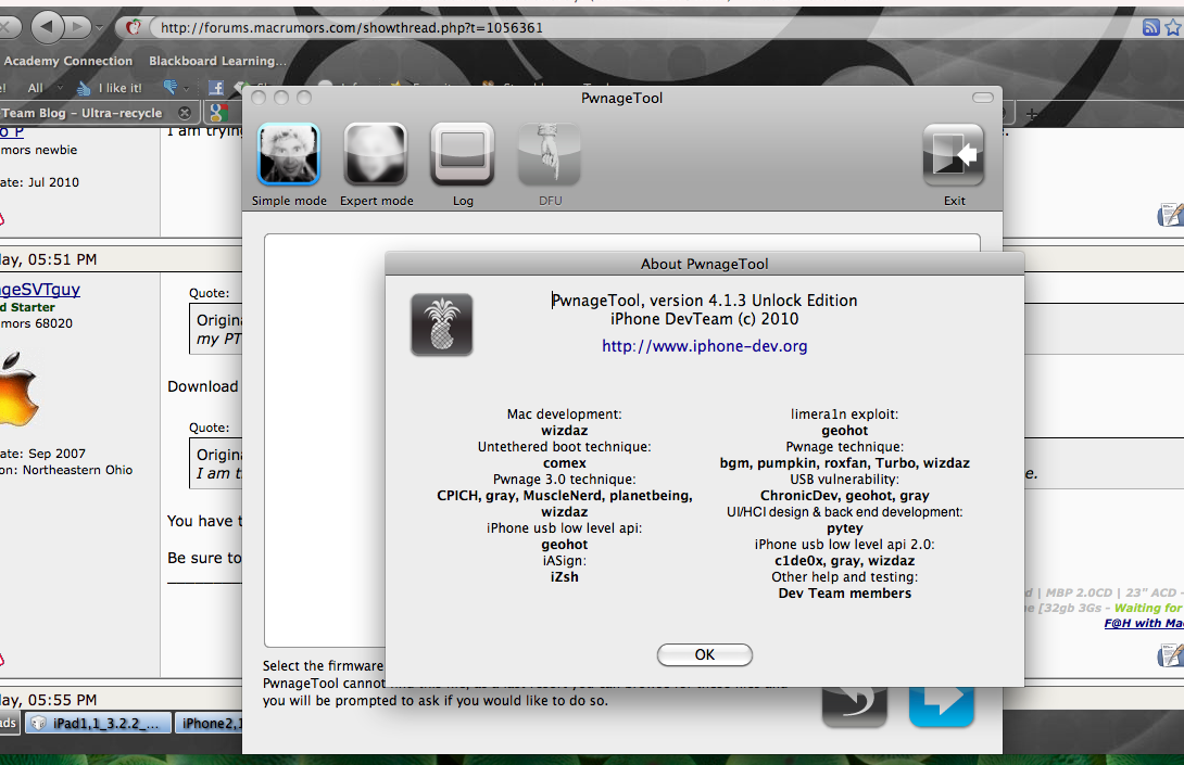

Download the newest Pwnage Tool 4.1.3 Unlock Edition,then read below.
I do have the newest PT... see attached screen shot
When I click on the 3GS it doesnt allow me to use the ipad firmware that I downloaded from the dev team blog. It never asks me to update the baseband? I dont know what I'm doing wrong. Ive also been reading that baseband 05.14.02 can't be unlocked? Have you heard this?
3GS 4.1 (8B117)
05.14.02
You have to select the iPhone 4.1 IPSW first before it asks you for the iPad IPSW. Download the iPhone 3GW 4.1 firmware if you don't have it.
This is why you use the iPad firmware so you can upgrade to the 6.15 BB so you can then unlock the iPhone. Please read the caution and risks first as I'm not responsible for anything you may do to your iphone. You do this at your own risk.
