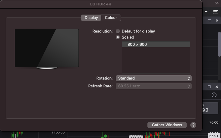

Picked up the LG 43UN700 4k monitor and instantly the resolution was 800 x 600.
In the options for displays it's the only option available too.
Looks horrific.
Any ideas?
