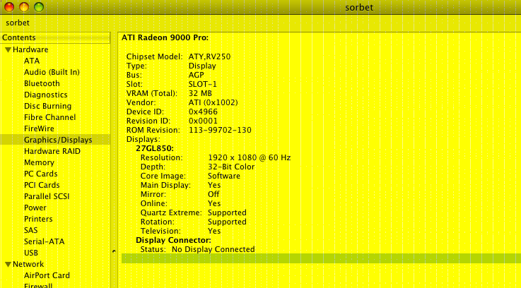

Update: it's actually a Radeon 9000 that's in the machine at present. Interestingly, OSX reports Core Image is supported (Sorbet).
Are you sure it doesn’t say “Software” in terms of CI support? That means “Yo d00d, the GPU ain’t good enough so the CPU has to do all the work.”
Reactions: Project Alice
You're correct! It says "Software" for Core Image support.

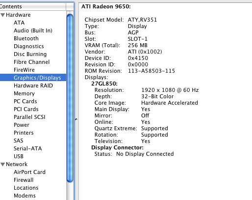

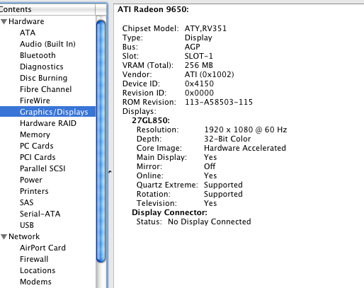

So I ended out buying a Radeon 9650 w/256MB VRAM. For it to work in the MDD's AGP 4x slot, I removed resistors R15 and R60, cut the rear tab off, slotted her into the AGP and she booted into OS9 first time, with early video (open firmware and boot picker) available again. Yay!
*But* the mouse button wouldn't work. So I booted into Sorbet Leopard (screenshot of card details attached), and downloaded the ATI 2005 OS9 drivers (https://www.macintoshrepository.org/1357-ati-os-9-drivers-january-2005-).
Reinstalled the dodgy old card, booted into OS9, installed the drivers, resinstalled the 9650, and now OS9 works perfectly, at least for 2D stuff.
In brief, the lack of early video output above seems purely down to a dying card - annoying, but there you go.
