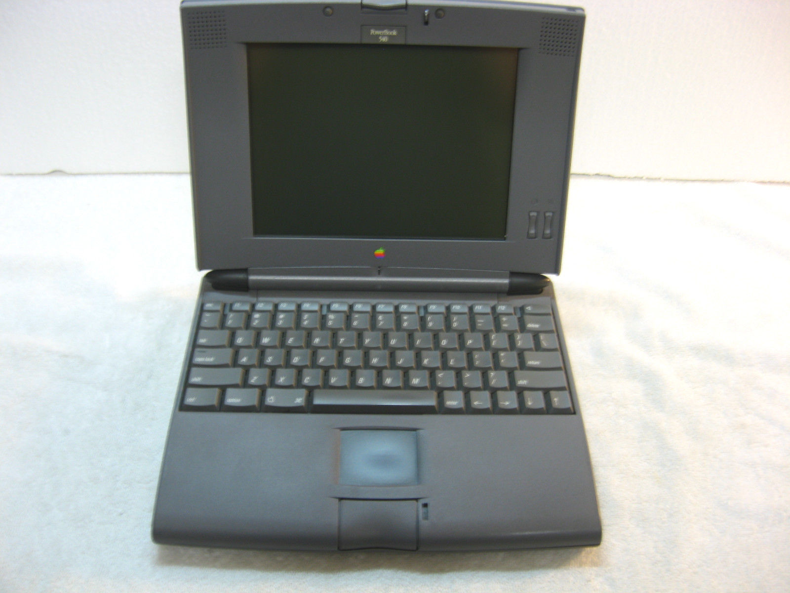

Just picked up a PowerBook 540, grayscale version.
Its a Motorola 68k 33Mhz,rest of the specs are on EveryMac.
http://www.everymac.com/systems/apple/powerbook/specs/mac_powerbook540.html
The PowerBook 540 is untested, but working or not I still love to have it.😀
The condition is great, from the pictures.🙂
Few Questions for the experts on the older PowerBooks.
Could I use my PowerBook G4 65w charger on it? Its almost impossible to find chargers for the 540🙁.
Is it possible to install dual batteries?(form factor is similar to the PowerBook G3(Konga,Wallstreet,etc)) If so, is it a certain battery I need or can I buy just 2 batteries and they will fit😕.
Anyone know where to get the 68k version of Photoshop? Would love to make some 16-bit images.

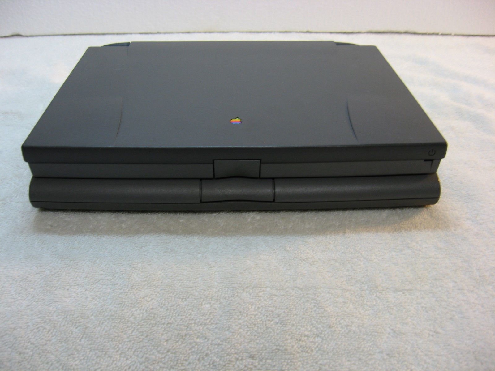

Wow that thing is HUGE! 😱 Look how thick it is!! 😱
I wonder what's inside to make it so thick.
The machine side looks like a good size, but why is the screen part so big?

I have a 520 and I hate it as it won't play nicely. Probably my one duff impulse buy. Chargers (Product code M1893) are very hard to come by, not that cheap (expect $20-25 on eBay) and only fit this 5xx series of Powerbooks. Nothing else will fit due to the weird four pin connector. It does have dual front bays so you can fit two batteries if you can find any that still work. Not sure if any aftermarket batteries are being made for this - I don't remember seeing any.
It is fairly easy to dismantle. The only tricky thing is getting the screen hinge covers off without damaging them otherwise a modest amount of Torx screws holds everything together. From what I could see, mine had System 7.1 on it with MS Word and Wordperfect but I cannot get it to stay on for more than a minute or two.
