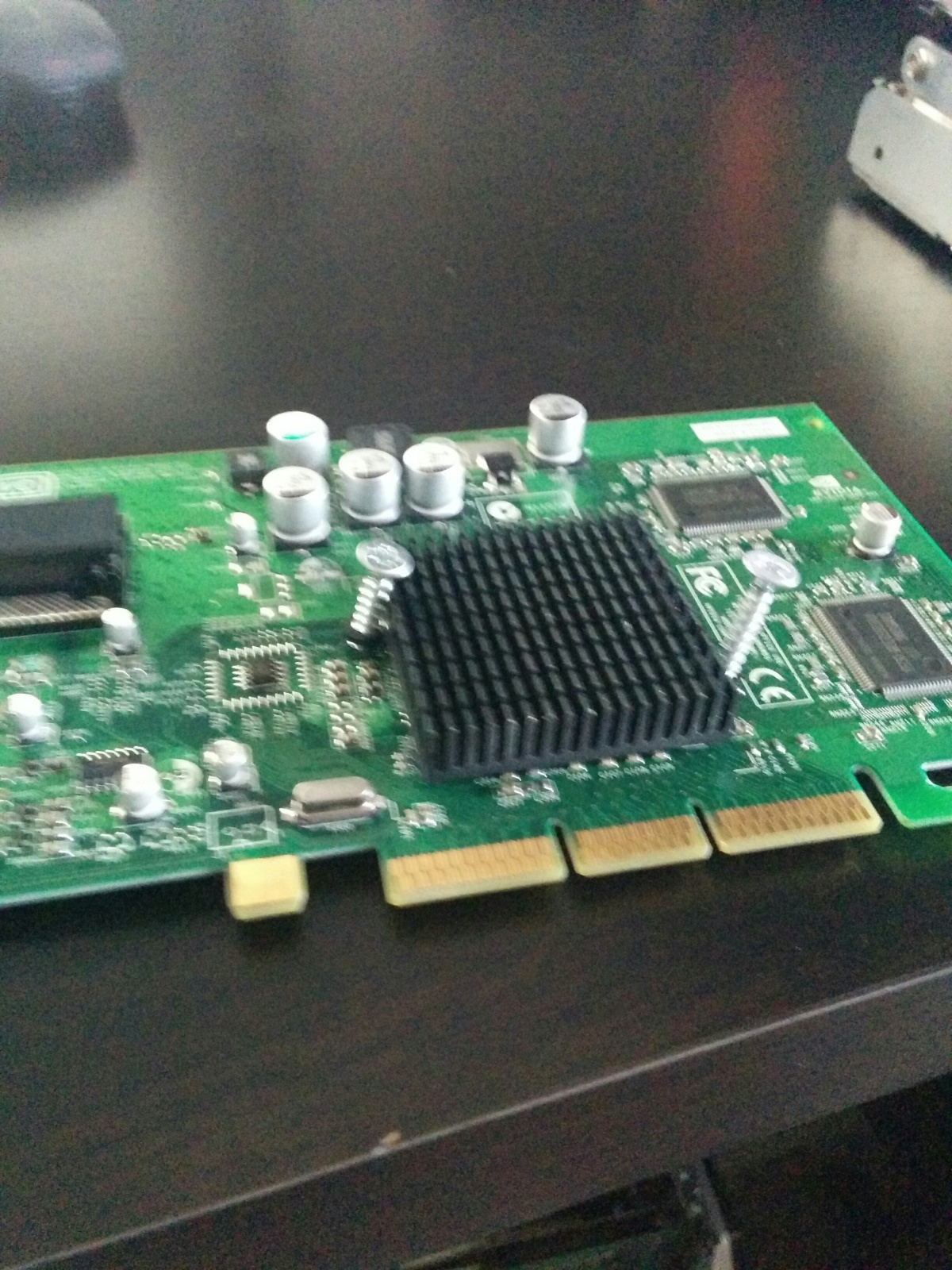

The reason for this, I went to pick up 2 17" monitors last night and the guy had an MDD sitting under a table, I asked about it and he gave it to me for nothing, he said it wouldn't boot it just hung on the grey apple screen.
Got it home, stuck in the 2 80GB drives along side the factory 80GB. Booted it up with my Tiger Disk and it hung on the grey boot screen. Pulled it open and spotted the problem straight away.
Pulled out the GPU and put the Rage 128 Pro from the Sawtooth in, booted it up using my Tiger Disk and it worked this time, cloned the Disk image from the Sawtooth drive over the factory drive and then put both 80GB drives from the Sawtooth into a RAID on the other controller in the MDD.
Machine is working away perfectly now, might try re-pasting the GPU from the MDD and replacing the screws with the correct ones and see if there is life left in it.

That might be the problem right there... I wonder what the story behind that was. Maybe a 5 year old or an 85 year old?
Its the Irish solution, put a few screws in it. Some of things I've seen over here, I bought a machine a few years back that had been used by a farmer in a barn, opened it up when it started smoking and found straw in the heatsink that was burning.
