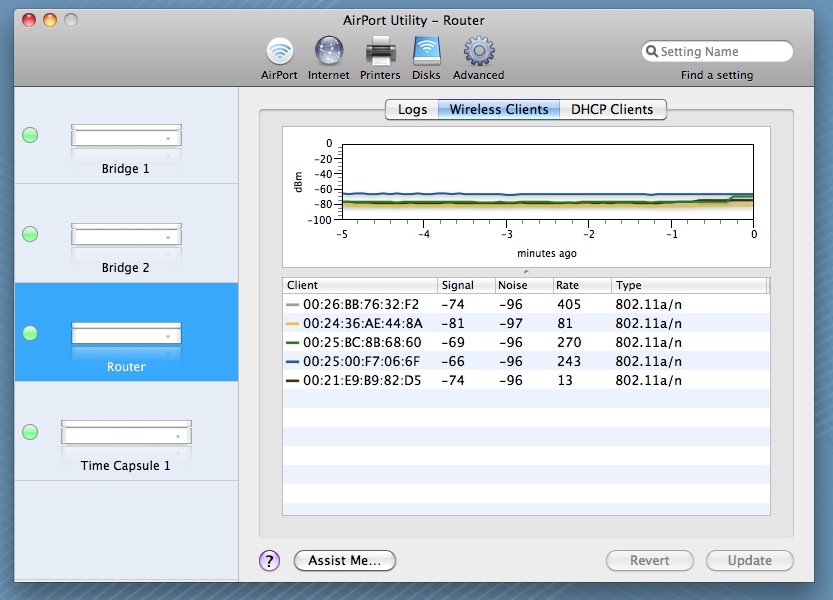

I read some articles that stated the new 3x3 AEBS and TC were only capable of 300 Mbps, those reporta are wrong, I bought a new AEBS and have that setup as my new router and I have a new TC setup to extend my Wireless N network they are showing in the Airport Utility speeds between 400 and 450 Mbps look at the first device in the list.
http://att.macrumors.com/attachment.php?attachmentid=200211&stc=1&d=1256419609

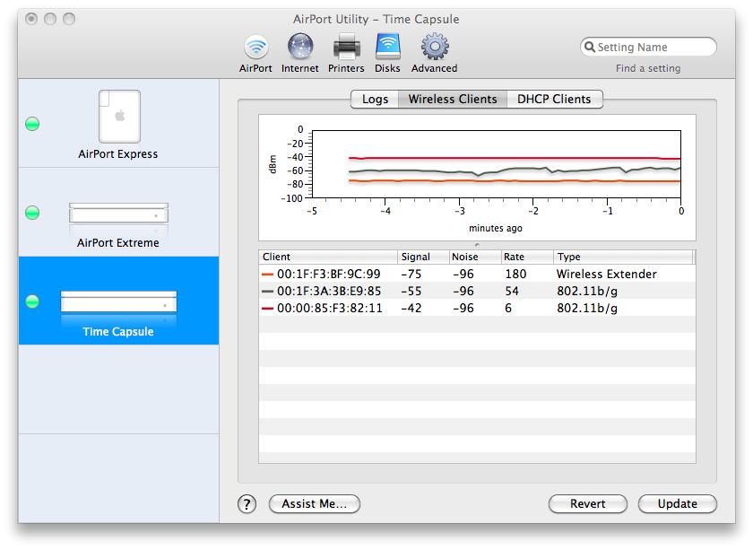

Hey David,
Can you break this down for us network newbs? What are we looking at here, what is the top device, etc?
I've attached a screen shot of my current setup.
Modem -> TC (dual band) -> extended by AEBS (single band) w/ AE attached.
The top Device is the new Time Capsule, it is in Bridge Mode Connecting to the new Airport Extreme which is being used as a Router, It is the speed on my Wireless N Network, The TC is set to Join the network an acts as a bridge I have an xbox 360, DVR and mac mini connected to the TC's ethernet ports, and they connect to my network via the Wireless N network to the router.
Bridge 1 and Bridge 2 are 2nd gen Airport Extreme's also in bridged mode one is in my office connected to my iMac, printer, and vonage device, bridge 2 is in my entertainment center and connects a Blue Ray, Apple TV, and a DVR wirelessly to the rest of the network.

In the Airport Utility select the device, than "manual setup" than go to the "Advanced Tab" > "Logs and Statistics" > "Wireless Clients" and there you will see the same screen I posted.
Regular 2X2 Wireless N is capable of 300 Mbps, the 3X3 is capable of 450 Mbps.

I'm getting conflicting reports on the 450mbps/300mbps capabilities of these new AEBS/TC. david is saying "yes - 450 mbps is possible", others are sayings the third-antenna is only for "spatial-diversity" - I think if somebody could just hook the thing up with an Intel 5300 laptop - we can get this all cleared-out!
The above image shows a new AEBS and a new TC connecting to each other at 405Mbps, not sure what other proof you need?
