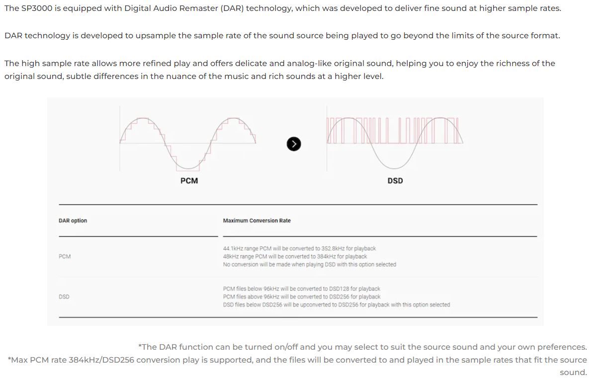

You can improve the 16/44.1 lossless SUBJECTIVELY. It's called mathematical interpolation. It's similar to upsampling a 480p to 1080p and difference is noticeably audible.

You add mathematical points to have an approximation at those sample rates that is in between the original samples. The method makes an audible difference. You should really buy a non-oversampling DAC and try it out yourself even perform blind test. Then use the same DAC and have HQPlayer oversample it to DSD512 and A/B test it.
When studio downsamples for music, the original samples that is taken at 1/44.1 KHz still remain and unless the studio equipment is exactly the same as yours, you won't have the exact match as the original Hi-res files when the DAC oversamples prior to conversion.
I'm not talking about FR here, but oversampling filter differences (linear, minimum, closed-form, apodizing, etc.)
