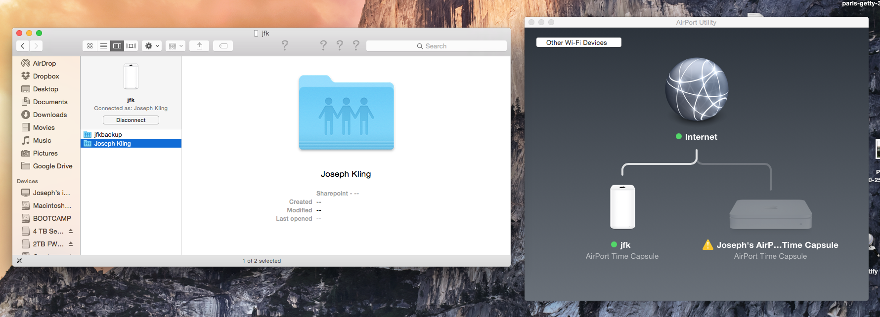

ok, that did not work. Attached is what I am seeing as far as a directory. Ignore the older TC as it is not plugged in.

When using the accounts setting, a folder with your account name will be created. Is this directory accessible at all? Is this issue only showing on the Yosemite machine you are testing with?
Well Ill be damned. It works fine on my 2008 blackbook running 10.7.5.
Now.....is this a known issue?
