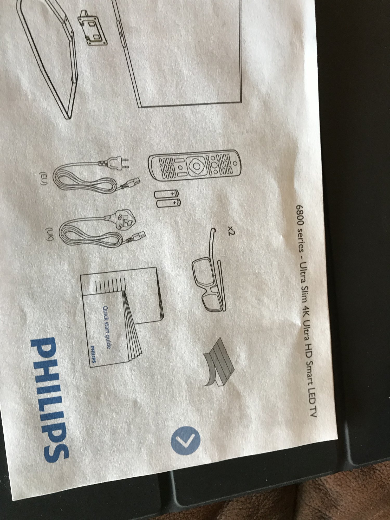

Thanks for responding Jason. I mixed up the name, the model was 6800.
50 and 60 hz 4K SDR and HDR are showing up as options in the format menu, however, ATV doesn’t want to switch to either one of them. It only directs us back to 1080p SDR.

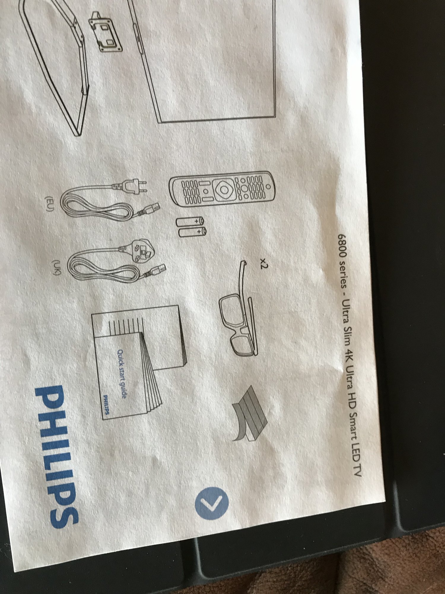

If you haven't, you could see if there's an update for the both.
might not mean anything but in the audio and video tab can you see enable dolby vision and what happens when you enable it? just curious.
ATV up to date. Could not see the Dolby Vision. Is it possible the tv is too old to support 4K from ATV despite it being a 4K TV?
Edit: Could this issue be related to the ongoing 4K bug with the ATV?
Eliminate layer 1: different hdmi port? If that doesn’t change it, a different HDMI cable? Next if wireless try a wired LAN connection if possible(a network throughput/bandwidth issue)
Also, if possible, try a different TV.
1. Make sure the TV software is up to date.
2. On my TV (Sony) when I plugged in ATV it prompted me to configure the HDMI port (Dolby Vision)
3. On ATV menu run ‘check HDMI connection’. Does this change it?
4. on ATV menu maybe try turning off ‘match content’?
Use original 4k content from ATV+ as your test video. It delivers 4K consistently.
Apple TV bug is wrong info display, DV will be stated as HD, minor. One2Grift stated a different HDMI cable.Yeppers to for that one. There are less expensive cables but I don't mind paying a tad bit more for the Belkin cable for the Apple TV. Because you can't see the DV section, it's cable or TV model, I would guess.
