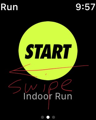

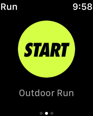

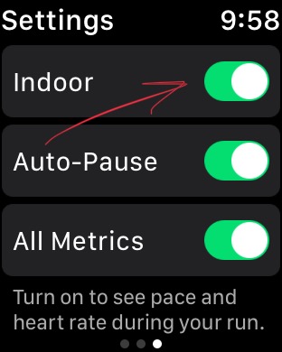

Just bought a shiny Apple Watch 38mm Series 3 yesterday and went today for the first run with it. I always used garmin with satisfaction. I left the iphone at home because i was confident about the apple watch gps. I started a session with Nike+ Club. Well, after few meters was obvious that the gps isn't working, at least without the iphone. I completed my run with a total of 0,03km (!?), indoor run (was outdoor), Red circle at zero, Green Circle completed, Blue circle at just a quarter. The green circle went full completed only after a manual modification of the distance run from the Nike+ app.
So, the problem is the nike+ app or is this faulty unit? Is there a way to test the gps without a new run?
Make sure you have allowed your NRC app access to the GPS. Not sure where it is in the settings. Go through both the my watch app and the settings on the iPhone
Added - you have to select outdoor run on the app. Indoor run doesn't use the GPS, and since it was your first run, there's no calibration data to estimate distance.
Yeah, i did a watch restart then tried a new run. The watch told me to open the NRC on the iphone. In the iphone app popped up a window asking me for permissions. I think now it is fixed. Thank you.
