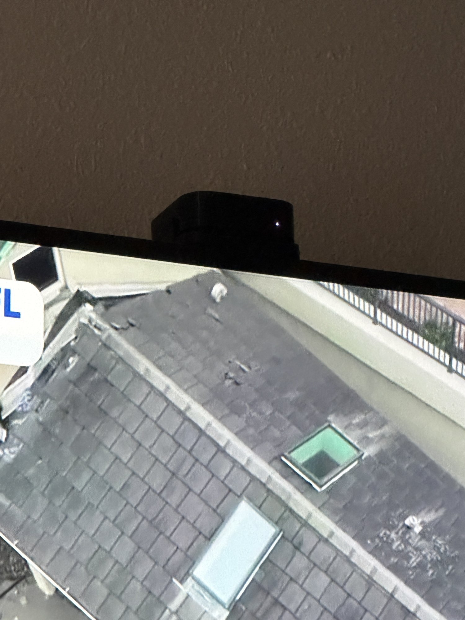

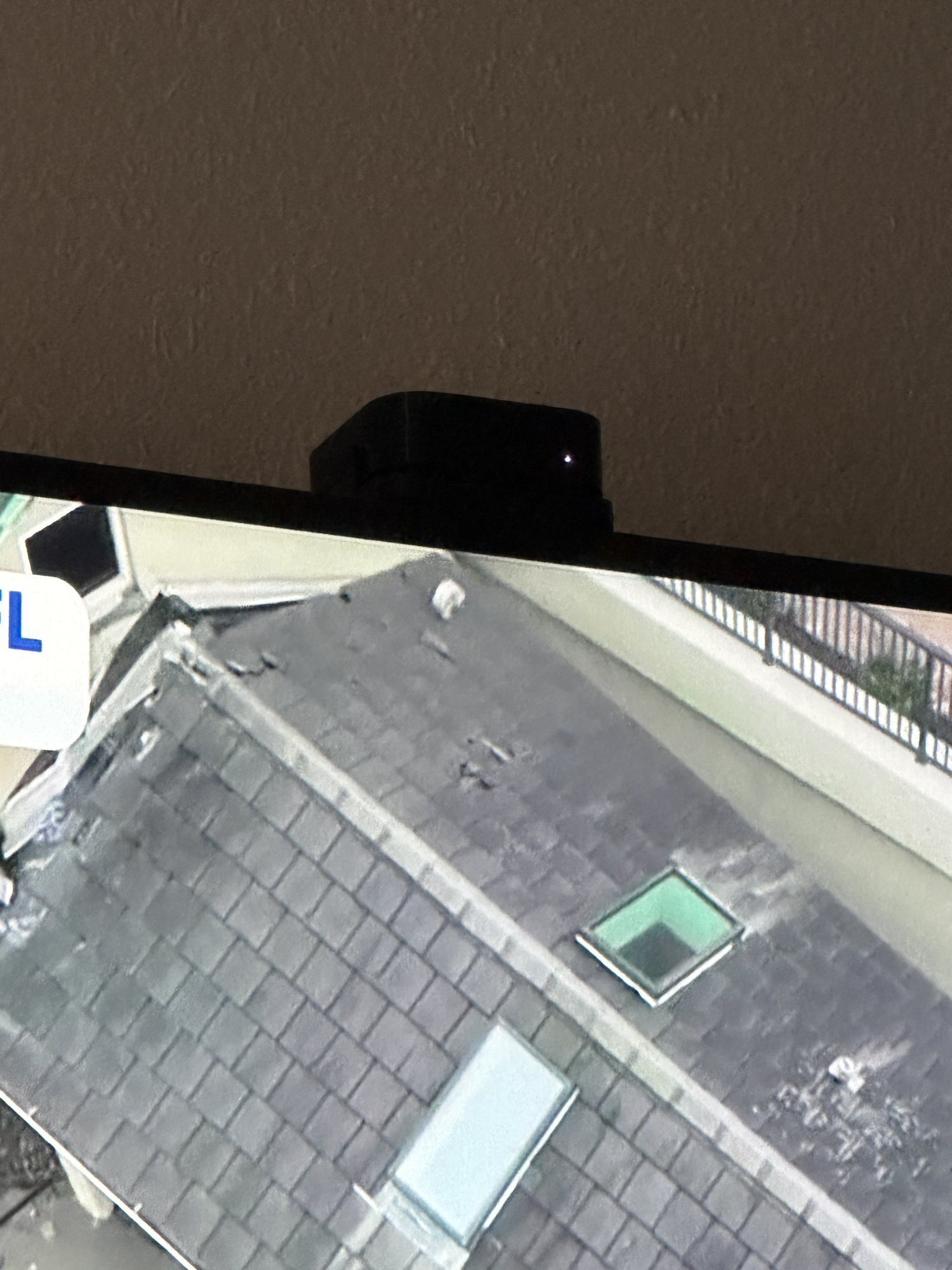

Thanks everyone, I have it sitting right on top of my tv. I tried moving it away from my tv and it still lost the connection. So I put it back.
