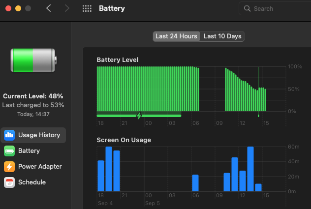

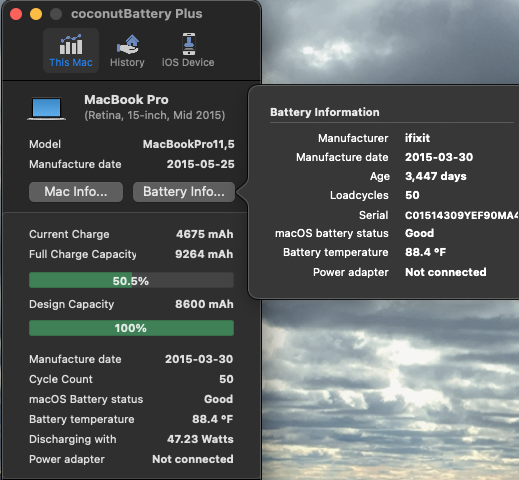

fyi.. I was trying to get more usage data for you on the iFixit battery in this..Apple published spec on OEM is "up to 9 hours iTunes movie playback".. not sure how Apple gets to that number.. I had the brightness turned down a bit on the screen and had it running thru my TB2 dock running a bit monitor for a while to start with and I got a bit over 6 hrs I figured. and if I let it totally drain maybe I would have made 7. I had iTunes movies playing the whole time and 2 safari windows opened watching football on each... I'm charging again and will run it not connected to anything and see how it goes..
